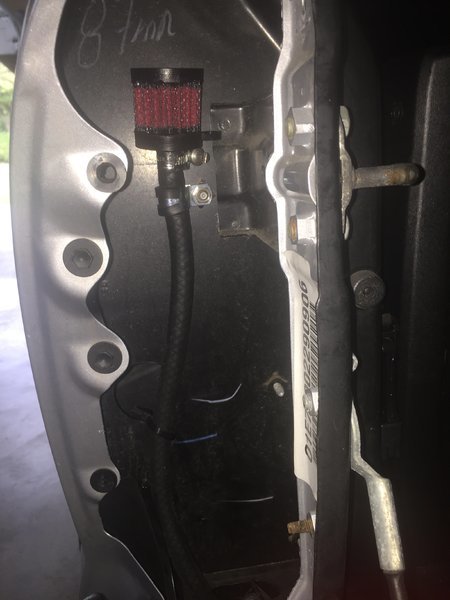

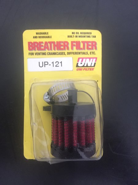

    I thought it made sense, so I changed my breather from the Toyota part to this:
    I figure it's pretty well protected, tucked in behind the tail light, and it's a true breather
