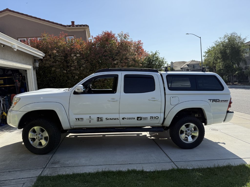

    Just installed bilstein 5100’s all around with OME rear leafs. Added drive shaft spacer, front springs are set on the top (4th) notch, freedom UCA’s. Got the alignment done and everything runs perfect. During the project I forgot about the front diff spacer and was curious if I can still add it without messing up any current setting etc? IMG_3112.png

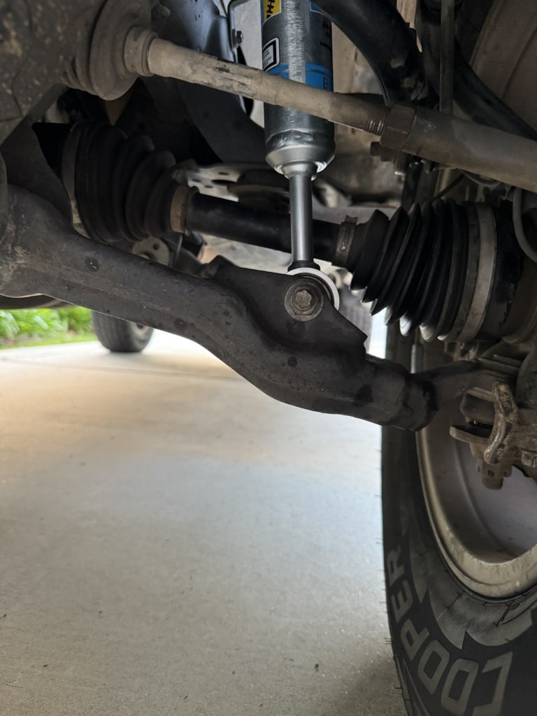

    Curious what your innner cv boot angles look like... any ribs touching? In my case they did with a 2" lift... with the diff drop they don't. I've had the drop installed for 18 years with zero issues... original boots stilll look like new. I've removed the drop a couple times for short periods (ribs still touched and re-installed.) In my experience having the diff drop on or off didn't make any difference with the ride quality... still no vibrations and handled great.

    Thanks yall, I have zero vibration and took some photos of the cv boots. Think I’ll skip for now. I also did the ECGS bushing change, it drives great currently. Appreciate all the input!
