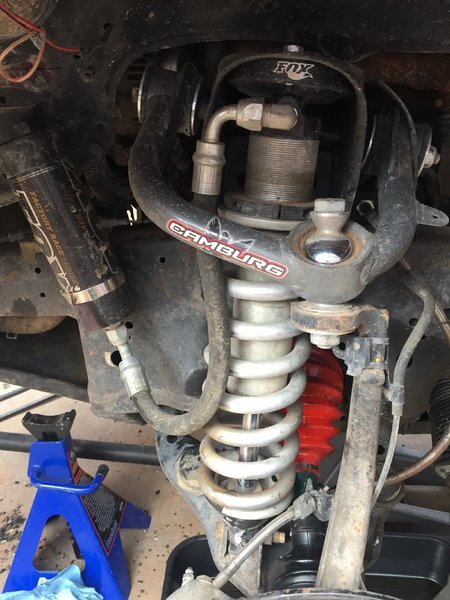

    I can grab one tomorrow of the driver's side, in a different town tonight. Not going to swap it until my tests next Wednesday though just so I don't obsess :rofl::rofl:
    2.5" coilovers. There are just under 2.25" of threads showing on both sides.
    This is the driver's side. Both coilovers are set the same, but can take pics tomorrow evening, since this is the wrong side and there's no reference. Tire is off the ground suspension is drooped

    Looks like a lot of pre-load to me. Also, from the clean threads, it looks like you've added some recently too. A 1/2" of threads translates to an 1" of lift.
    Which coils and what are they rated for?
