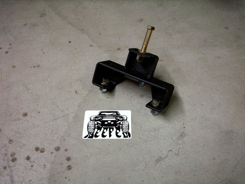

    I make CB drop brackets for the first gen and the Tundra, I really need to get the 2nd gen bracket available. It has cured vibe problems on every truck that got one. I'm not saying it's a magic cure all, (has been on the Tundra's though) but it definitely gets the center of the shafts to a more normal angle since most kits only come with a few washers to use as spacers. I'll get moving on this bracket for you guys. I add a 3rd attachment point to the top that uses a factory hole in the crossmember and gives some extra support in this important/sloppy area.

    wait for beefed taco to make a bracket for the 2nd gens.
    i just put one of his drop kits on my 1st gen and the difference is amazing. truck drives smoother, accelerates smoother... just feels all around much better. the quality of the bracket was top notch too
    thanks again Brian!

    I agree....wait for beefedtaco , to make you a diff drop and or a carrier bearing....DONT waste your money going to ToyTec...( I did and regret it)
    I'll stand in line to get the carrier bearing that he has a pic of

    yeah, the beefed taco part is much better than the junk toytec sells
    here's his 1st gen bracket i put on my truck over the weekend
