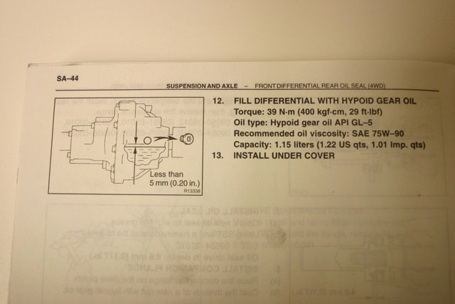

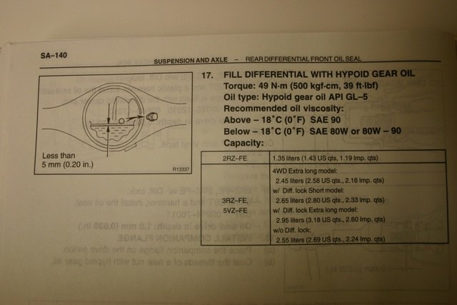

    Reading the fluid specs (see attached) from the FSM and am wondering if I truly do need two different weight gear oils for the front and rear diffs?
    Since the text gets all messed up wrapping inside the diff box, I am having a hard time reading it. The way I'm reading it is:
    Front diff: GL-5 75W-90 1.2 quarts
    Rear diff w/locker: GL-5 80W-90 3.1 quarts
    I have no idea what the "2.8 quarts" is referring to nor do I know what the SWB and LWB stand for.
    Can someone let me know what gear oil to use for the diffs and how much? Thanks in advance.

    See this is confusing.
    I was also given different info from one of the best mechanics in town. They say use 80W-90 for diffs front and rear.
    And holy crap... $15 a quart for Amsoil Severe Gear? :eek:

    I assume those 2003 specs are the same for my 1998?
    Also... can I put 80W-90 in there even though 99.8% of the time it will be above 0 degrees? And just have it in the diffs for those rare times it does get that cold?
    Will it have any negative effect?

    You don't want too high a viscosity that the cold will turn it to sludge and won't protect the gears until you get them warmed up enough to not be sludge.
    SWB = Short Wheel Base, rear diff capacity is 2.8 quarts
    LWB = Long Wheel Base, rear diff capacity is 3.1 quarts
    Front diff capacity is 1.22 quarts regardless.
    You want to fill it up to about 5mm from the top of the fill hole.

    Straight outta teh 2003 FSM for ya:
    Shouldn't be much different than your year.
