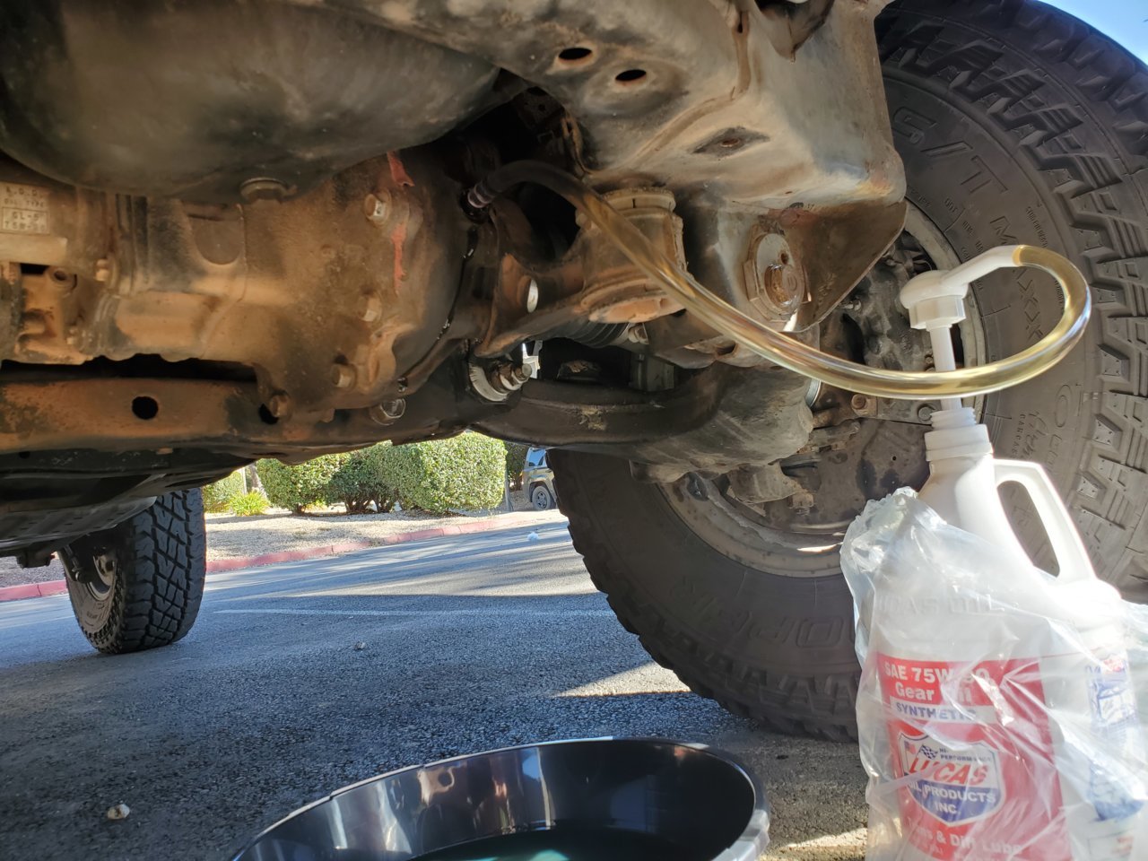

    As mentioned, 75W90.
    Personally, I used Lucas -
    Good time to replace your fill and drain plugs with Lexus variants;
    90341-24016
    90341-18060
    Don't forget the crush gaskets either;
    90430-24003
    12157-10010

    The trick really is making sure the plug is completely clean; it's pretty shallow as it is.
    I used a pick to scrape any and all dirt and grime that was caked in there.
    Afterward, I placed the allen-head socket in the plug and whacked it with a hammer a few times to "break" it loose. Went to town on it with a 1/2" drive wrench to loosen it and it came out easily without issue.
