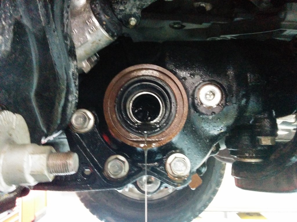

    I have a 2-1/2" level kit with a front diff growl. I have diff spacers installed.
    Finally got around to doing this, Toyota may fix this in the future but it was driving me crazy.

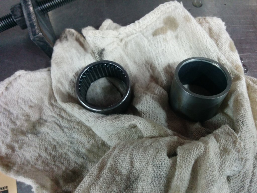

    On some 2nd and 3rd gen trucks when lifting the front left axle bearing would growl when unloaded. There's a TSB, which updates the bearing with a new style, this doesn't apply to the new trucks but we tried it on mine anyway. It reduces the feel of the vibration but doesn't completely fix the issue.

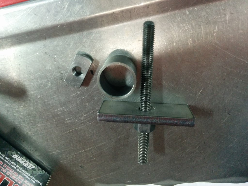

    So this is my second time doing the bearing replacement and it only took me ~20 minutes.
    It has removed nearly all of the vibes that I felt in my left foot while driving! Very happy with the aftermarket in this situation, Toyota may fix it, but I don't see it happening shortly.
    I didn't drain the oil this time, but I still removed the extra skid plate to prevent the run off from dripping into it.
