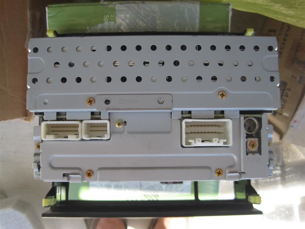

    what is the difference in the jbl and non jbl head units? can anyone post pics?
  2. Aug 25, 2010 at 7:58 PM
    yosh2000
    yosh2000 Well-Known Member
    Sep 18, 2007
    #2733
    2,940
    Denver, CO
    '17 Tundra CM 5.7

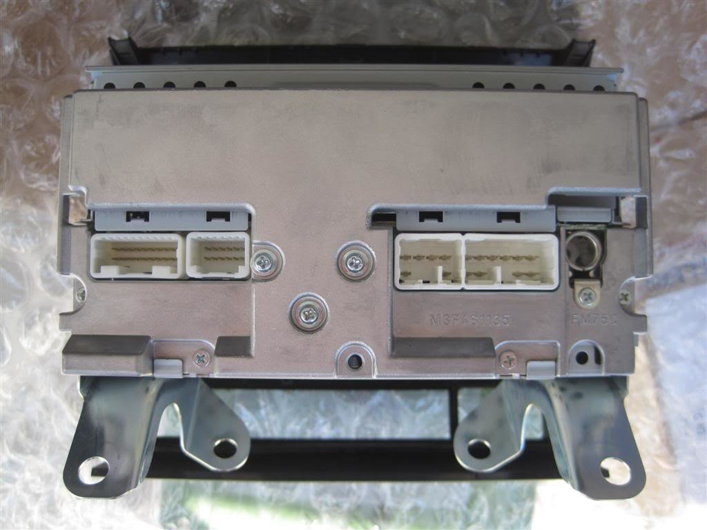

    photos below. the main wiring harness is different between the two. as stated above, the JBL has a separate amp, whereas the non-jbl has an integrated amp, hence the different wiring harnesses.
    JBL
    NON-JBL
