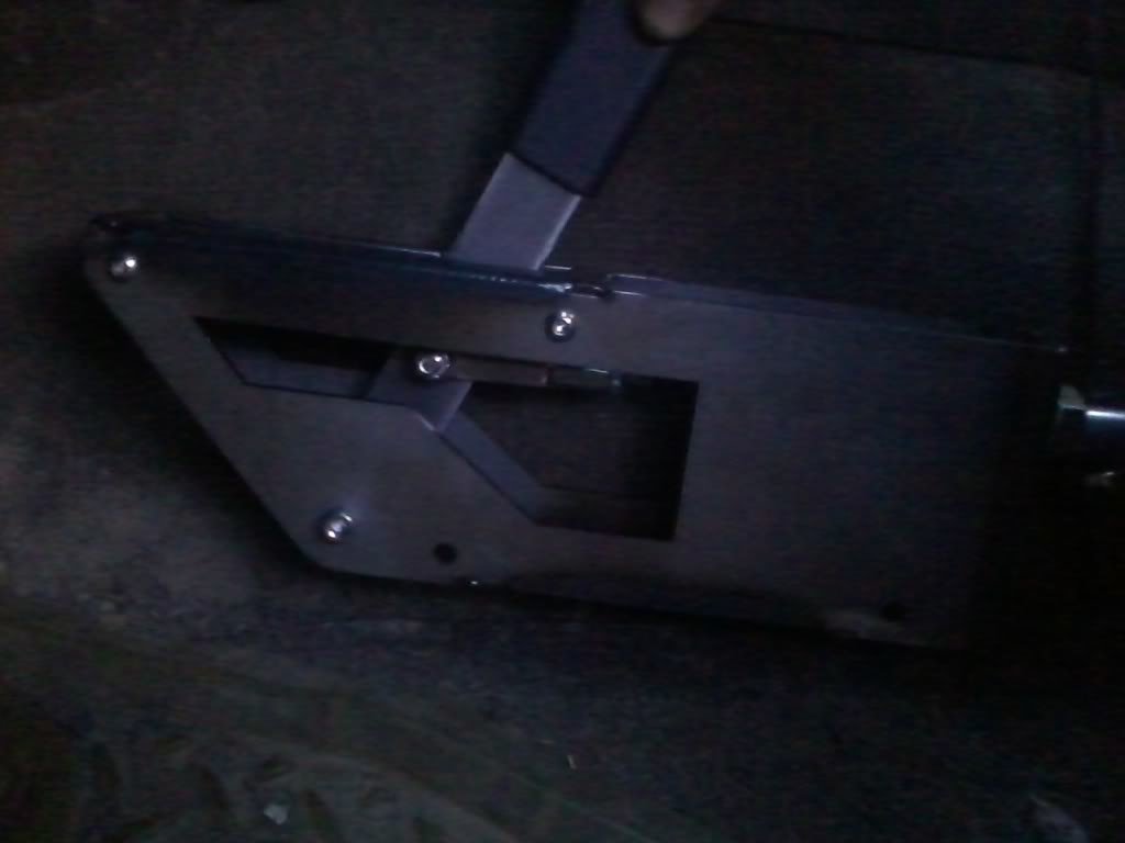

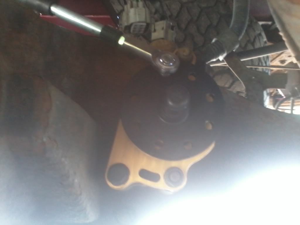

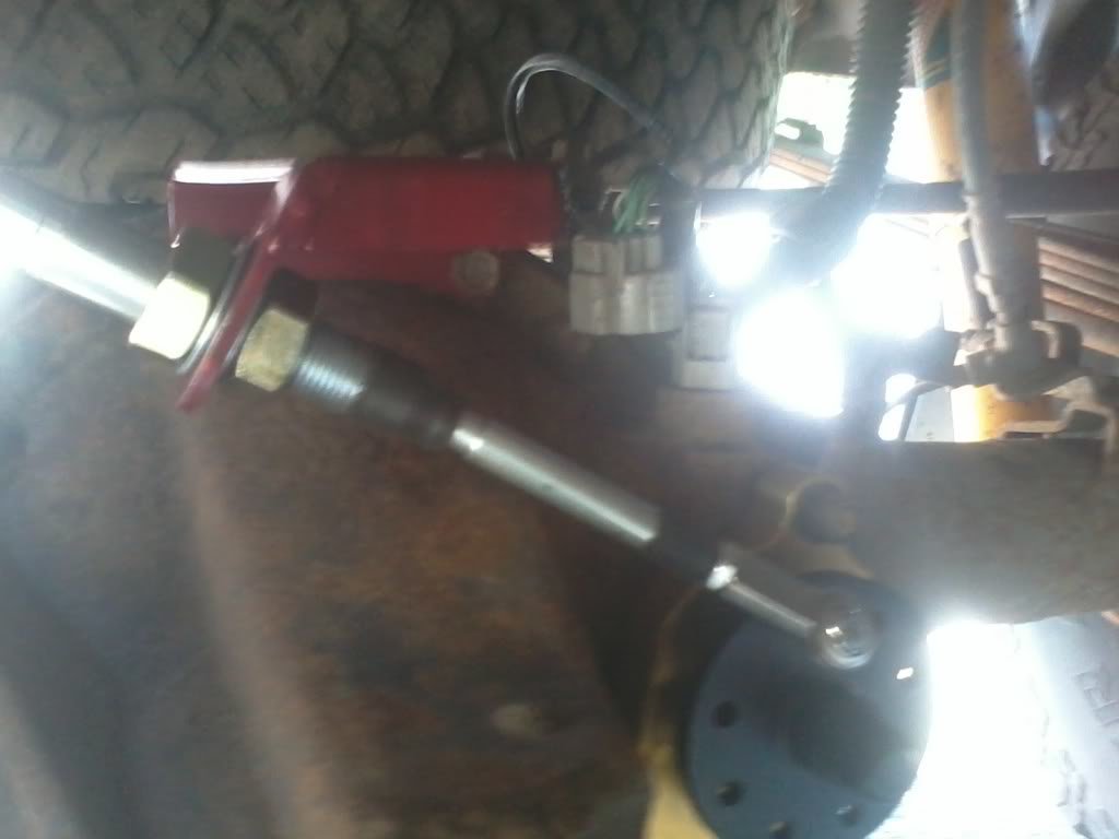

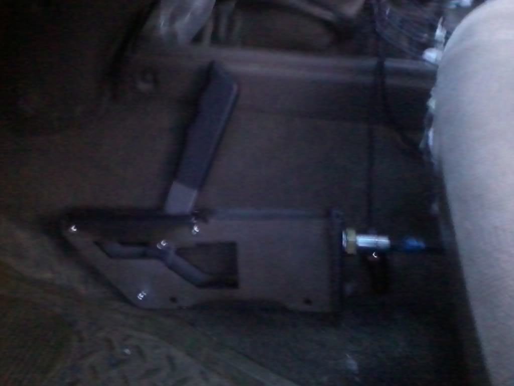

    Alright, so i got the kit on tuesday and have been waiting for a nice day to do the install. I will be the first to admit that i was a bit worried about the 600 dollar price tag, i mean really? 600 bucks for some aluminum, a cable and a lever? No way. But when i opened the box and saw what they sent, i was really impressed. The whole kit is very well put together.
    The hardest part for me was figuring out how to mount the lever and route the cable. I think the lever assembly could be smaller for our already small trucks.
    The instructions they send are great. And they tell you that you will end up taking the actuator out several times.......yup. You may get lucky, not likely. When you are trying to rig it all up, it will save a whole lot of time with two people. One to actuate the lever, and one under the truck trying all of the holes and positions on the actuator. i did the whole install in a couple hours. I still have not routed the cable in the cab the way i would like and still have to mount the lever. But all in all it is a really good setup. Everything is solid and not going to break on a whim.
    I will poat up pics when i figure it out from my phone.

    Nice. What does the lever in the cab look like?
  17. May 13, 2012 at 5:30 PM
    #17
    Afwrestler1986
    Afwrestler1986 Well-Known Member
    May 20, 2008
    #6768
    3,650
    Johnstown, NY
    01 trd 4X4 ex cab manual
    Gray wire, Some lights in the bed area, and some character marks throughout.
    Like i said, i didn't get around to mounting it yet, but that is where it is going. The cable willgo out the soft plug on the back of the cab. (in the cubby hole)
