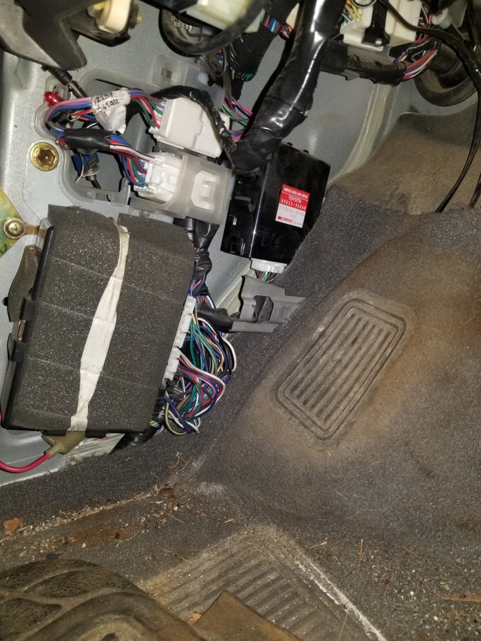

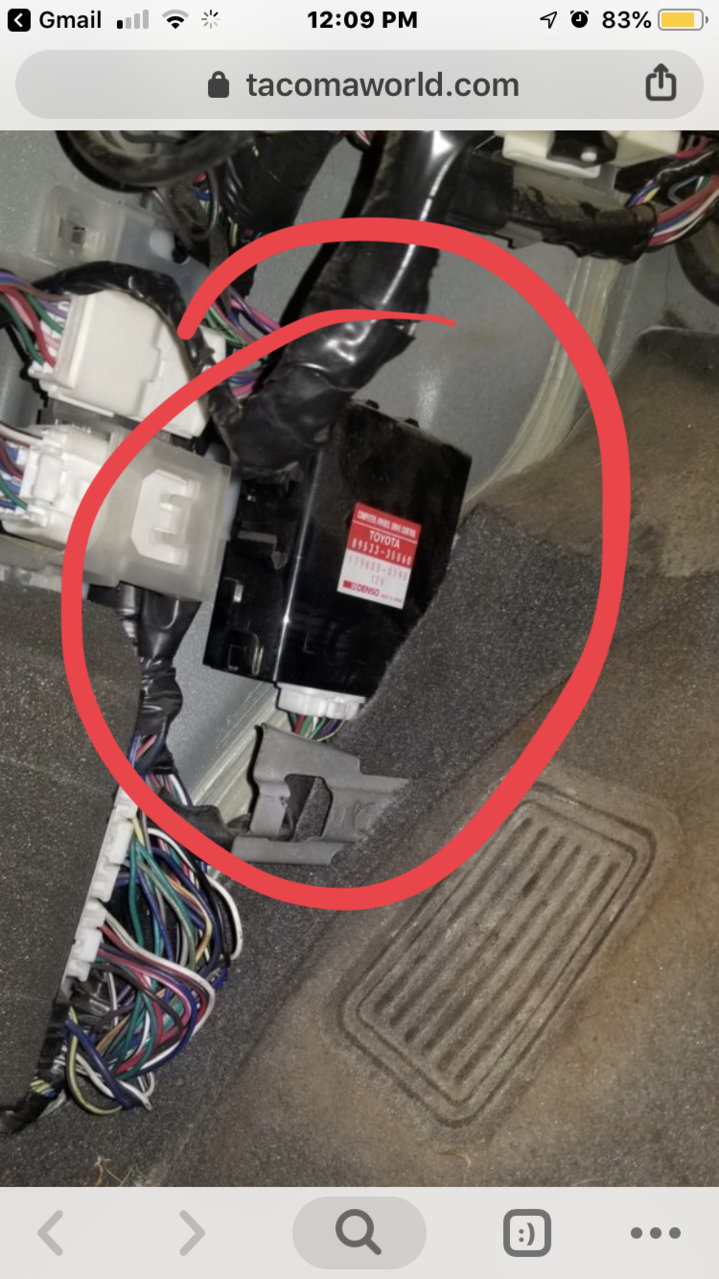

    @jeg0005 ok 8 finally swapped over my non e locker rear now im want to disconnect the module you said thats on the driver foot board which on is it here a picture
