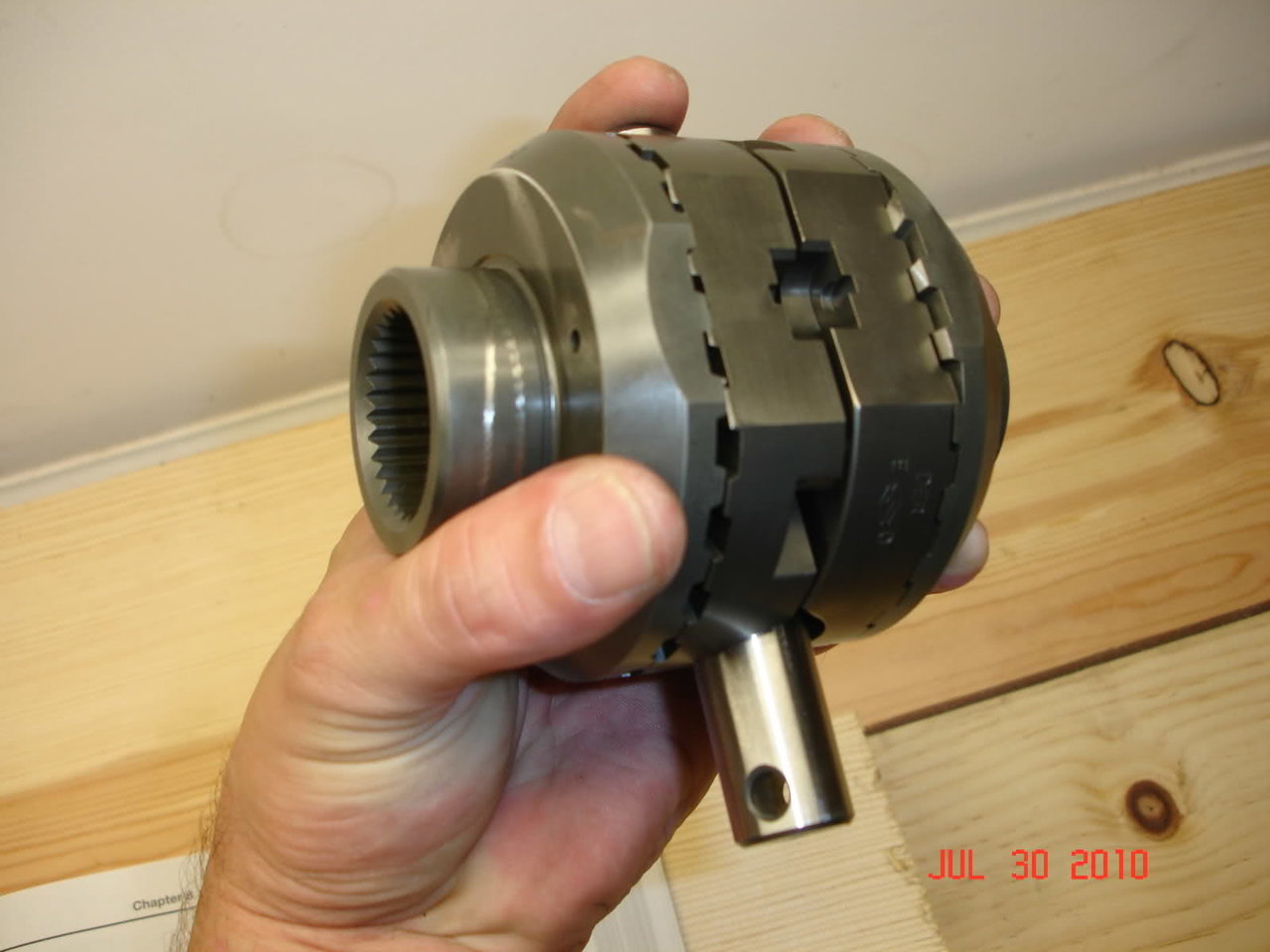

    Dude. Get a powertrax no slip. Drive up here to SC and I'll help you put it in. I just did mine.

    ok one more question. I hear the lunchbox style lockers make your rig jump and click and pop and crap when driving. Does it make that much difference on road? or will it keep the road quality ride I'm use to? I just don't want to go buy it and then hate it when I'm driving around on road.

    Supposedly Powertrax fixed those issues with the No-Slip. The Lock-Rite was the one that ratcheted and popped.
