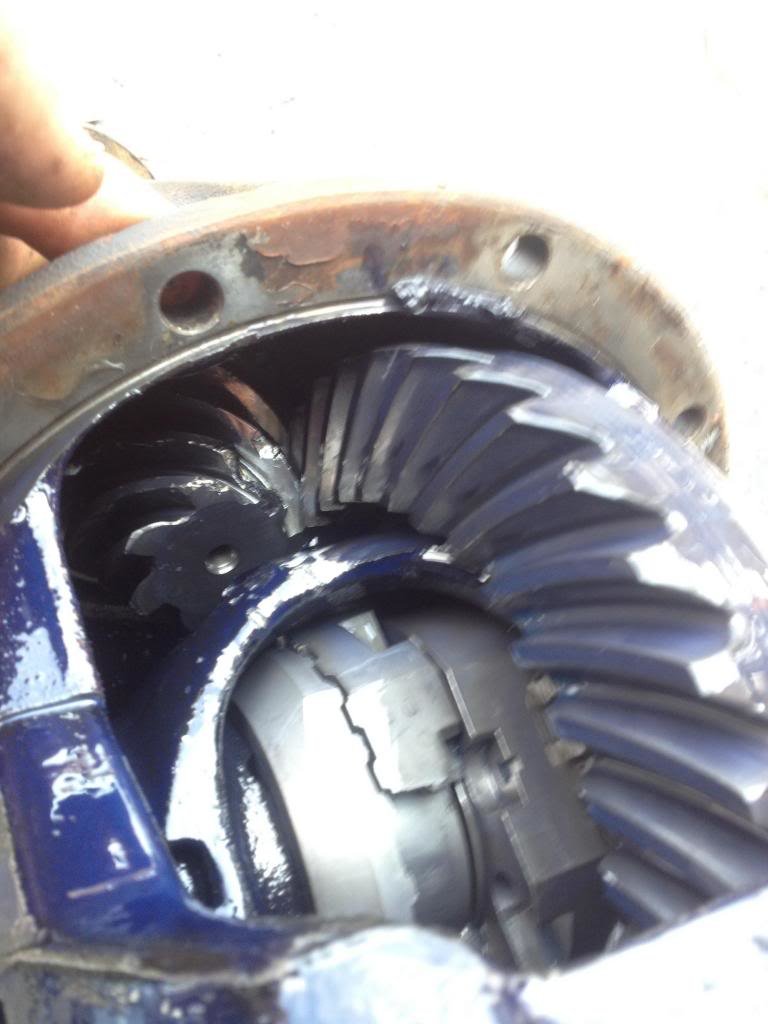

    I'm not a no-slip fan at all. Mine let go while I was running down the interstate. Wrecked the gearset and the transmission in one shot when it locked up the rear end

    Air lockers are not as reliable as mechanical lockers like a Detroit, Spartan/Aussie/etc. There are air lines to snag, compressors to fail and solenoids to fail. I've had to replace the solenoid on my setup once already and it sucked wheeling all day with no locker. With a mechanical locker you will always be locked.
    According to Chase at ECGS the no-slip is a junk design that will fail with time. One of the halves sheared on mine and a big chunk came out

  14. Jan 14, 2016 at 7:00 PM
    #34
    Snowy
    Snowy Is neither here nor there
    Feb 5, 2014
    #122349
    3,469
    Connor
    Winnebago, IL
    3 linked 98 Xtra cab
    Stock-ish
    Carnage pic...
    MR2[OP] likes this.

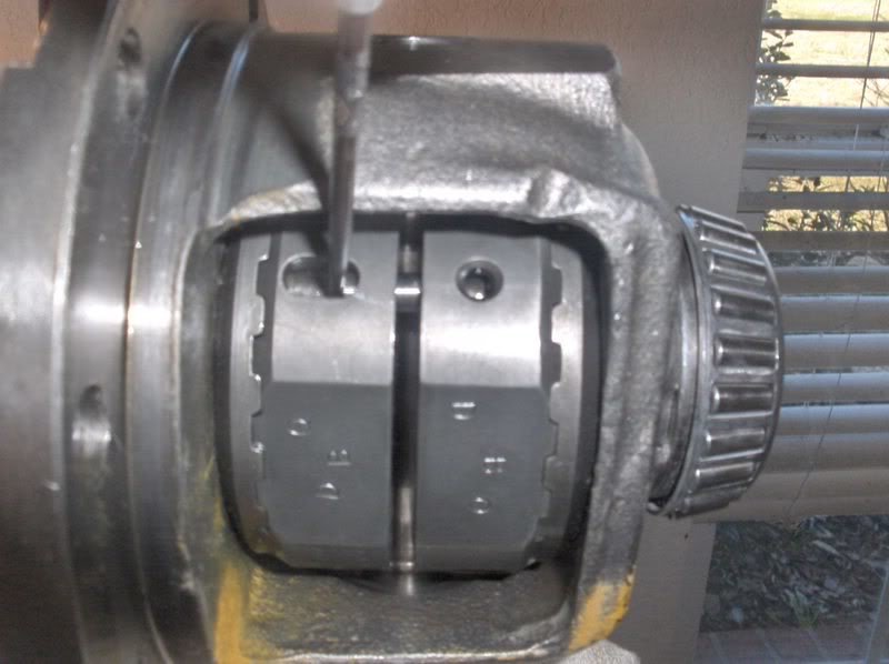

    A "lunchbox" locker is a locker that is installed in your existing carrier. You are just removing the spider gears and replacing it with the locking mechanism.
    A Detroit, ARB, and a few others replace the carrier entirely, usually stronger than stock and requires that you pattern the ring and pinion gears again. This is usually the route most will go when they replace the gears too. two birds with one paycheck.
  17. Jan 14, 2016 at 7:29 PM
    #37
    Deathbysnusnu
    Deathbysnusnu Work is just a daily detour to happy hour.
    Oct 4, 2013
    #113825
    17,295
    Brett
    Fort Crawlins, CO
    Vintage Tundra
    Dog, camper.
    Detroit full locker minus the ring gear.
    This is a Lockright, or a "lunchbox locker"
    This is a lunchbox locker installed in a stock carrier, but not a Toyota.
    And the good old Lincoln Locker
    MR2[OP] likes this.
