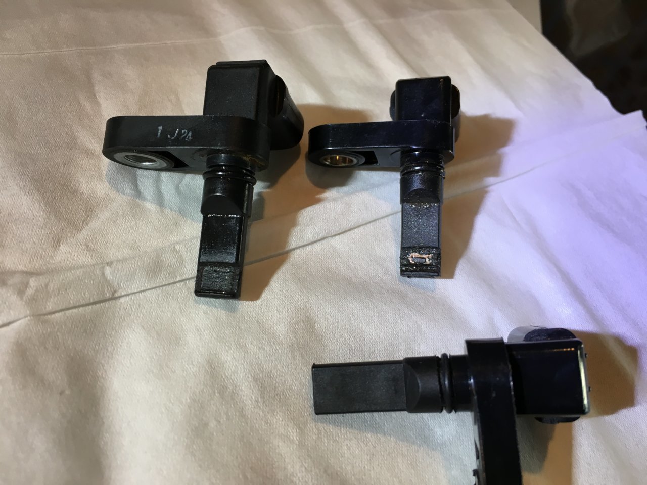

    Well, a day or so after I replaced the driver’s side rear wheel speed sensor, the ABS/Brake Warning lamps illuminated again while I was driving on the freeway to work.
    So, today, I decided to pull the diff breather and check it. It appeared to be clear, but I went ahead and cleaned it out with brake cleaner spray and compressed air. Just for the heck of it, I decided to pull that left rear wheel speed sensor again, to wipe it off, just in case my issue WAS the breather, and I was lucky enough for the axle seal to quit puking oil.
    On pulling the sensor, I noticed that it was very visibly damaged. It had a groove chafed into it, where something in the wheel hub had been continuously or intermittently making contact with it.
    In the attached photo, upper left is the original left rear wheel speed sensor that I originally pulled out. Upper right is the new eBay wheel speed sensor I had installed last week. Bottom is a new (right rear) wheel speed sensor, for comparison. So, you can see the damage there.
    So, my guess is that I have a failing left rear wheel bearing, and that is allowing some movement in the hub, letting something (possibly the bearing itself?) contact the sensor. The failing bearing also probably allowed enough play in the hub/axle to cause the axle seal to begin to leak, hence the oil that was on the sensor.
    Just for comparison, I pulled the right rear sensor to look at it. It is undamaged, but, as I said before, it did have some oil or an oil/water emulsion on it as well.
    So, it looks like you guys were right, originally. I’m probably looking at replacing my rear wheel bearings, as well as the seals.
