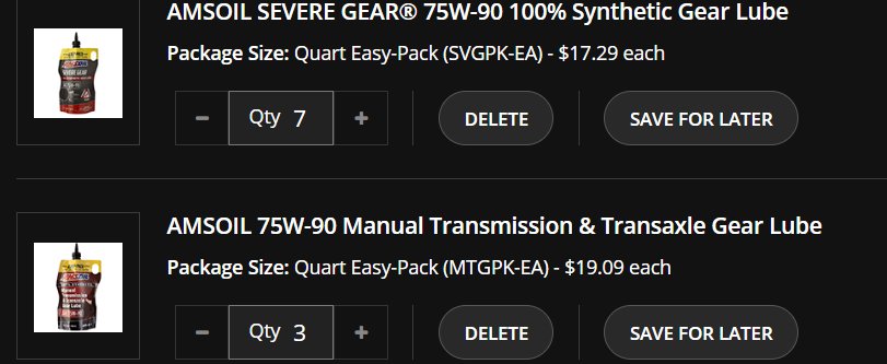

    Awesome thread here! I'm getting ready to change my MT transmission and both the from and rear diffs. Would y'all say I am good to go with the following?
    Appreciate y'alls help!

    Yep. Those should do it.
    Severe Gear in the Diffs.
    MT in the MT.

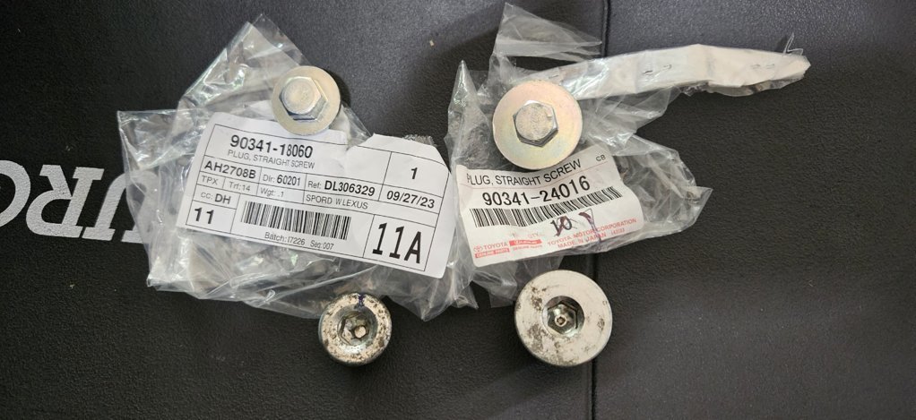

    I know the front diff has a hex plug, the rear does as well? Planned on ordering the lexus style bolt for the front, didnt realize I needed more than one. About to tackle the diffs next month sometime after changing my MT fluid earlier today..

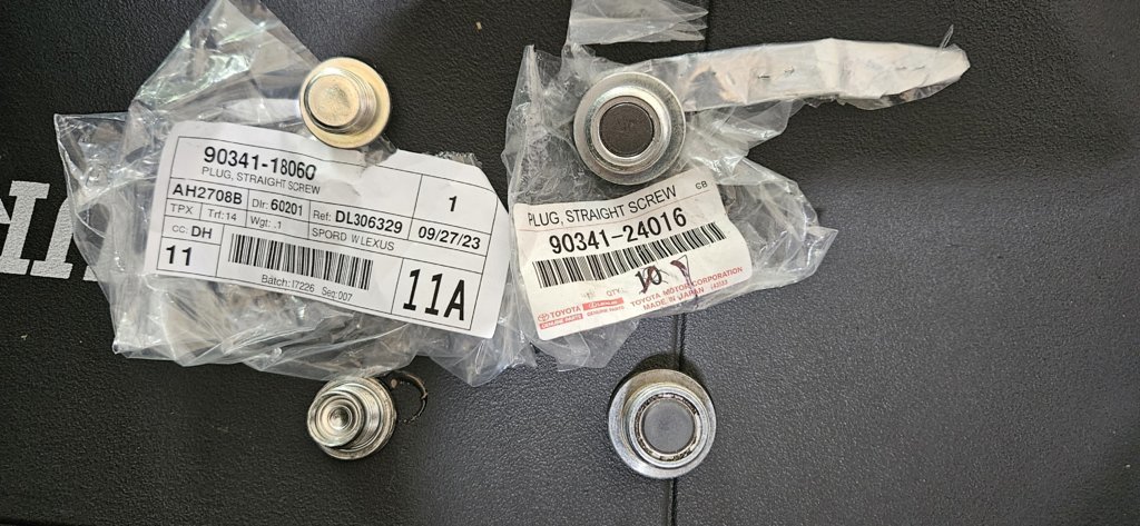

    The rear already has hex plugs (external, socket style) so nothing needed there. You just need them for the front. What I have in the picture is comparing the fill/drain of OEM and Lexus male hex.

    I find 90341-18060 to be a correct part number but 90341-24016 maps to 90341-24014. Can anyone confirm this? The last thing I need to is drive the distance to the dealer and find this is not correct when I try to install it.
    Edit - Called the dealer and ordered the -24014 and 90341-18060. I'll take my drain/fill port plugs with the recessed Allen head to the dealer with me to confirm thread pitch/diameter.

    Thanks for this. I called the closest Lexus dealer and they confirmed both. The Toyota label on the drain plug confused me a little. I now have both external hex head front differential plugs secured! Front end rebuild projects are so much fun!
