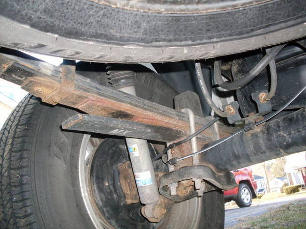

    Sorry it took me so long to respond. My measurements are PS 21-3/4", DS 25" (driveway isn't exactly flat :eek:). I figure I'd average out in the low 23" range.
    Here's what my leafs look like after 1 year, 9 months:
    For comparison, here's what they looked like last summer:

    Looks good. I think I am going to leave in my ol spring as well. Is all the hardware that comes with the icon long enough?

    Yes, I just did the same set up, tsb pack and added the icon aal with the over load in place. With my 700# icons up front at the setting they came with from the factory, I'm almost leveled. Granted I have plate bumpers front and rear and a winch up front also... My truck is pretty heavy.

    Thanks for taking the time to take the pic. I just might go this route as the AAL is stiff.
