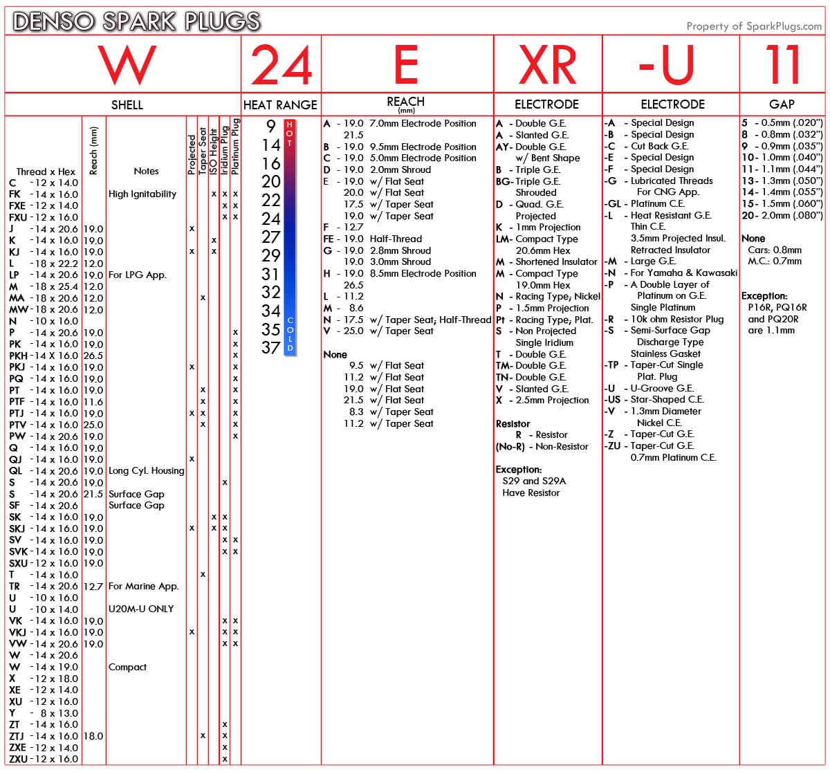

    Last number is just what the plug comes pre-gapped at. 11 is 1.1mm or 0.044", here is a chart that shows what the part numbers mean.
