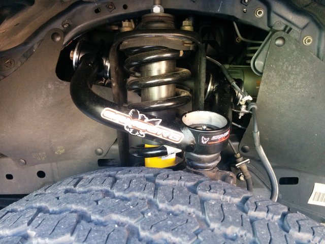

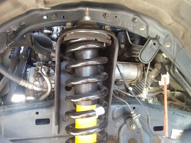

    Was pretty straight forward install.
    Lubed them up with Super Lube PTFE :)
    Thank you TacomaWorld Community for your assistance...it is appreciated :)
    Alignment shop is next on the list.

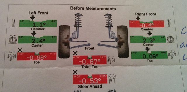

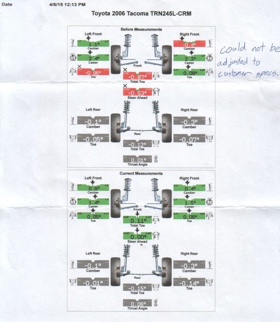

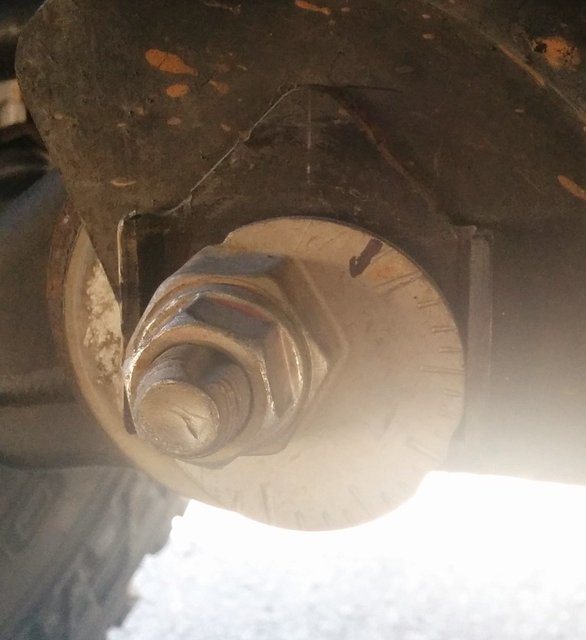

    Need to find a new Alignment Guy.
    Here are the BEFORE specs (notice Caster is 2+, due to newly installed Camburg UCAs):

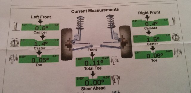

    Here are the Current Specs.
    The Alignment Guy said it is the best he could do...
    The truck drives fine around town...but I was hoping for more caster :(

    ^^^ Probably have the lower control arm alignment cams facing the wrong.

    Thanks Dan,
    Will post up some pics tomorrow.

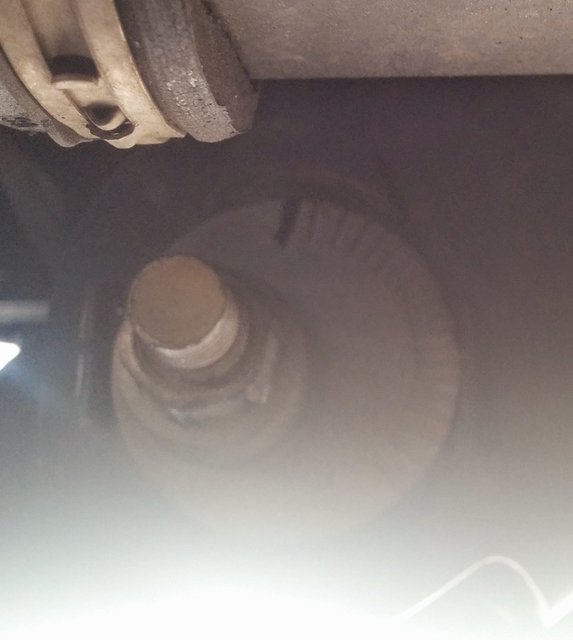

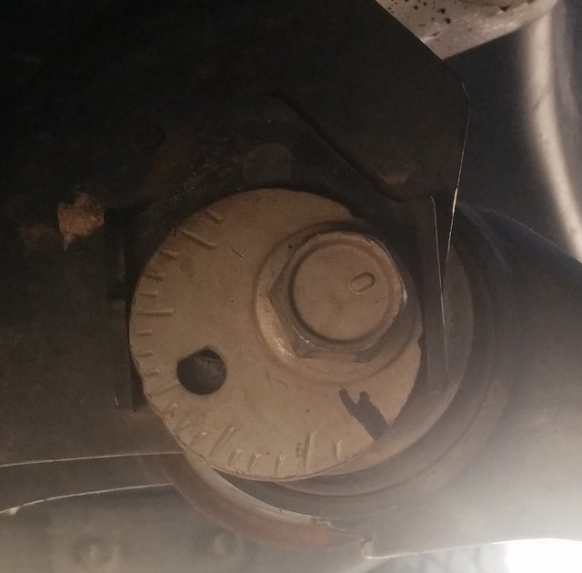

    Drivers-Side Alignment cam Pics...
    Forward-front (hub position/orientation ->)
    Forward-rear (hub position/orientation <-)
    Rearward-front (hub position/orientation ->)
    Rearward-rear (hub position/orientation <-)

    All assistance with my alignment issues (lack of caster) would be appreciated :)

    The following are the current alignment specs...post UCA install
    The caster is set back to Stock :(
    The Good news is it no longer pulls to one side :)
    I requested More caster and from the "Before Measurements" values, higher values are possible...
    Looks like I'm going to have to find another Tech.
