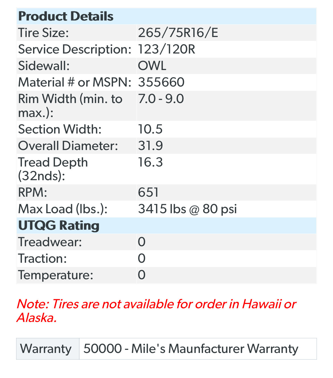

    Hello, 2021 TRD OR moderate off-roading in Florida and overlanding in Arizona
    looking on Sam’s as they have some good deals on tires. I’m interested in the toyo at3s. There is 2 separate at3s available on their site, and I was wondering if anyone can interpret what the difference is for them based off the specs. One is an E rated tire which is believe means it’s stronger and harder? But would love if someone more knowledgeable can break it down? Thank you!

    In the Toyo Open Country A/T3, you actually have 4 options. Both the 10 ply rated, E load range and the 4 ply, SL standard load come with a black sidewall or white lettered sidewall. The heavier load stands to be a stiffer ride and carries more weight more efficiently with a higher air pressure max. The 10 ply is not necessary for a Toyota Tacoma but some forum members want the durability factor when off roading. Please take advantage of our Low Price Guarantee when shopping for tires. We will not be beat.:thumbsup:
