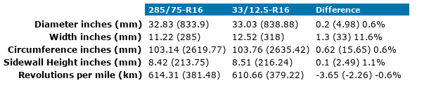

    i tried the calculator with no luck - it only does metric.
    i wondered how much bigger the 33 was and if it was possible with trimming and boxing the bodymount to run a 33 with the toytec c/o at 3" (or 3.25").
    I am getting ready to byu new wheels and tires and trying to find the "right size". also what does a 305 translate into? 33?

    You will have more rubbing with the 33-12.5-15. I personally don't care to hear my tires scrub up on the frame. Even with 285-75-17 I still had to trim to keep from rubbing and my kit is set a little over 3 inches.
