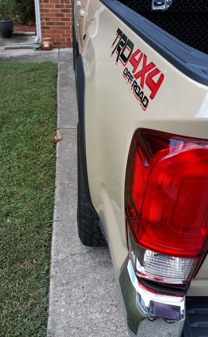

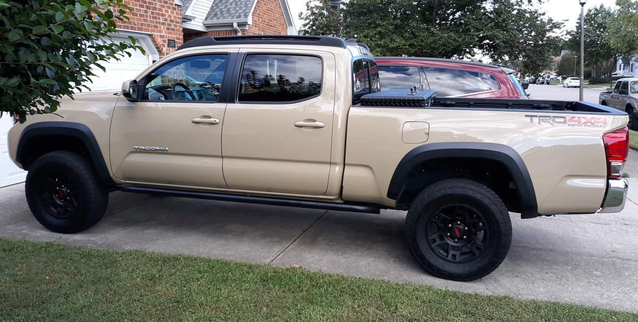

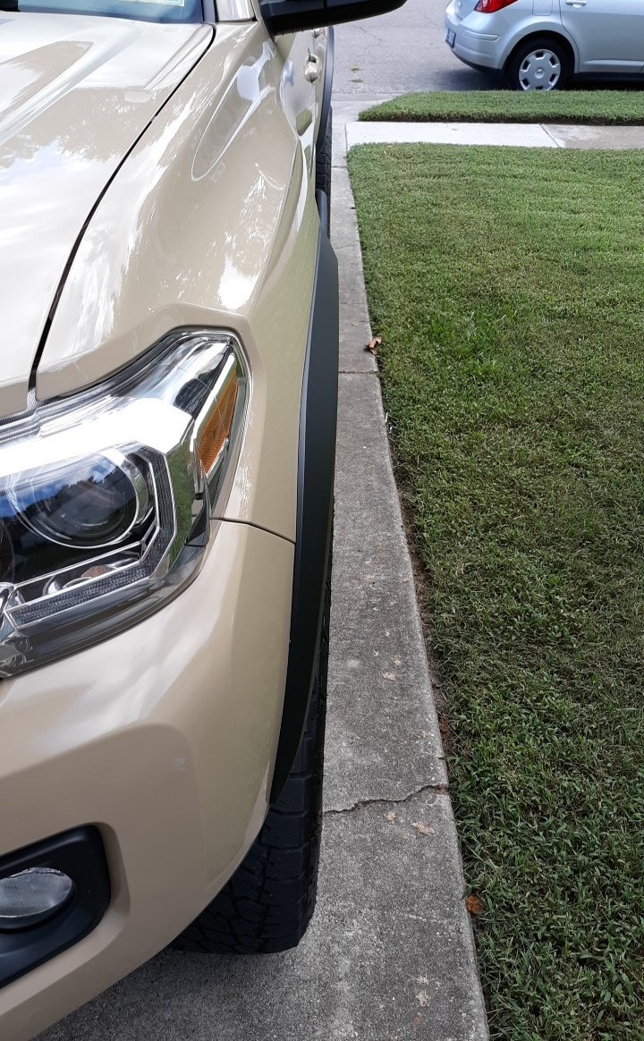

    I get this much poke with the 17 inch TRD 4runner wheels with a 265/70/17 tire. As you can see I'm even with the fender flares.20180929_165353.jpg 20180929_165321.jpg 20180929_165526.jpg

    So the MTs are out. The Pro seems close. Are there any well-known brands that produce aftermarket rims with a similar offset and width to the Sport rims?
