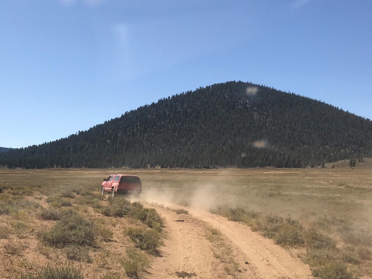

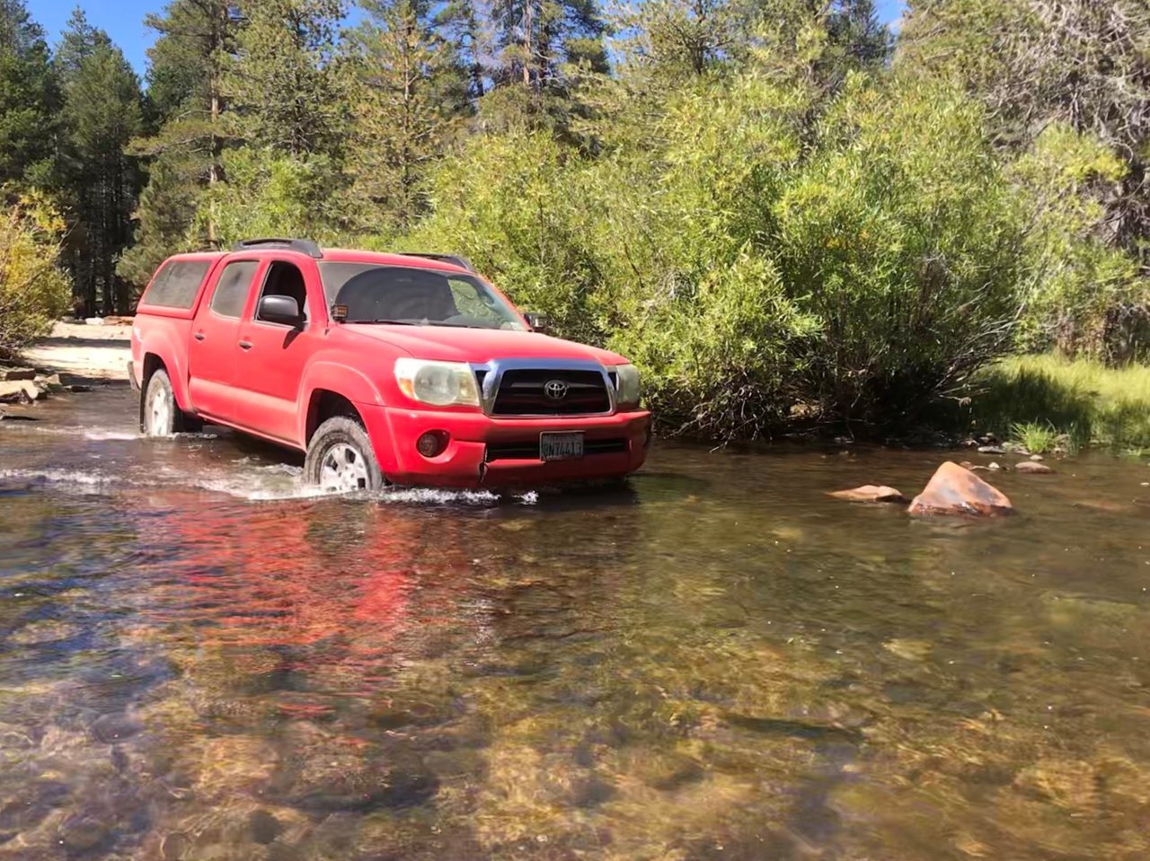

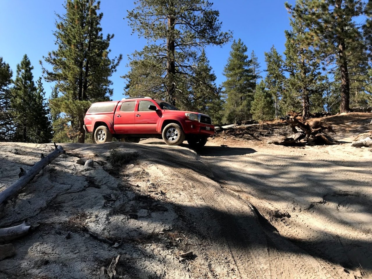

    I've never had any trouble with my recall-replaced stock leaf springs - but I guess I'm just a pavement princess who only picks up a bag of mulch every other Sunday...
