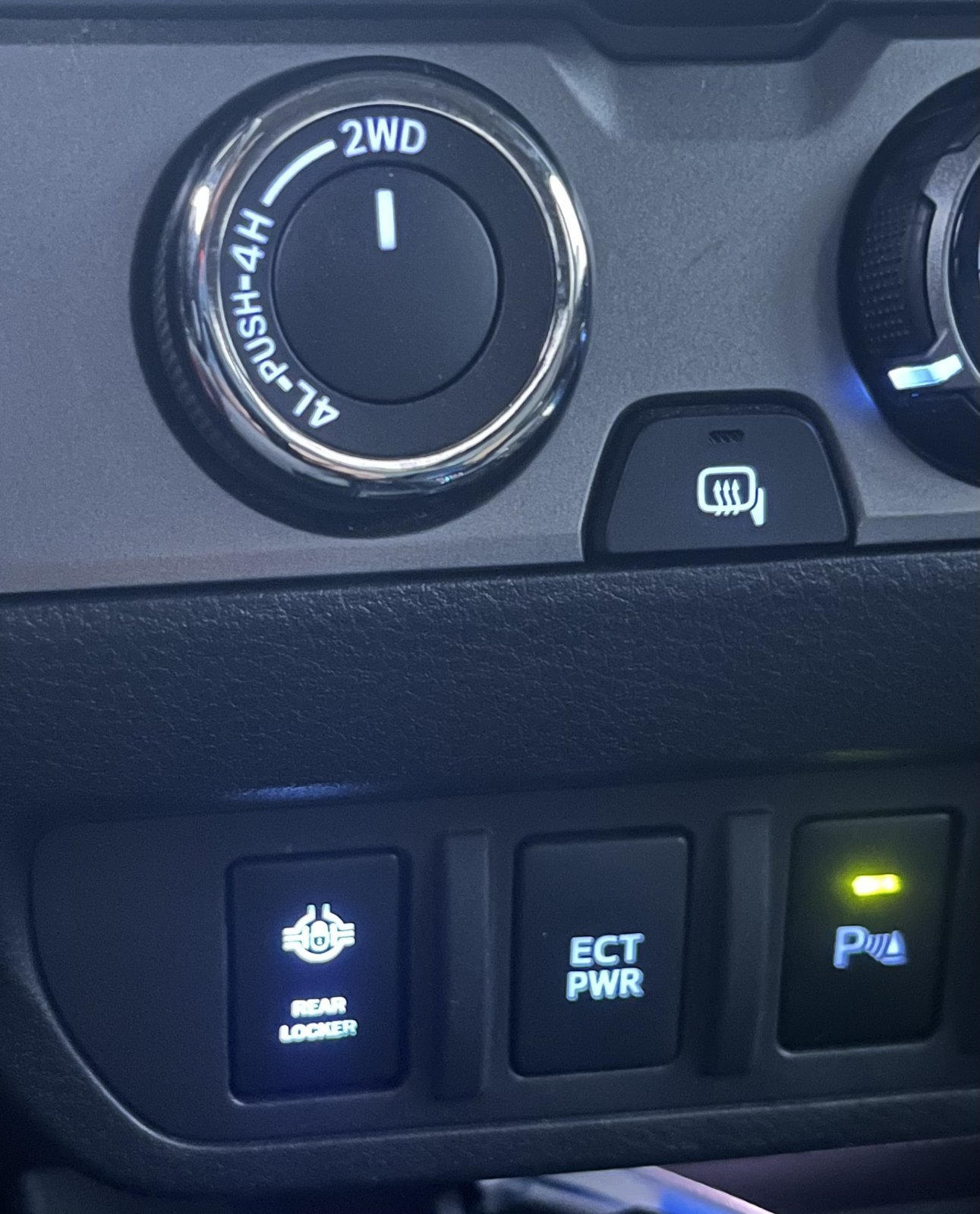

  18. Mar 19, 2024 at 1:35 PM
    #18
    Topanga Taco
    Topanga Taco BUZZING NITRO
    Jan 6, 2018
    #240465
    2,089
    Rick
    Topanga Strong Southern California
    2018 SR5 4x4 DCSB Harrop rear E-Locker
    The Magic of ALSD RCI-skid RAS-Sumos Bilstein 6112/5100
    Here is the diff no pun intended! :rasta:
    I used to own two 2nd Gen OR’s, last was a 2012 with ATRAC. After owning the SR5 since 2018 with numerous outings in 4WD, and recoveries using the TRAC system…it is super bad to the bone. With lockers, it’s a stout machine I can only imagine. I only have the rear. The quick anytime locker is a great function. Highly recommend it for a little bit more traction, and sometimes a lot.
    I almost shopped for a 2023, but then realized I have been super stoked with the SR5ster, and most importantly, the fact that the OR traction control systems can only be used in 4LO(?).
