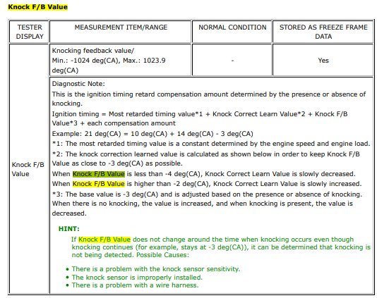

    Is there an OBD application that can display ignition timing and knock suppression( retardation)?
    That would provide "cause and effect" evidence of why high octane was "more better".

    tuners with ott and kdmax both told me that even without a tune these trucks make more power throughout with higher octane fuel. almost all modern vehicles will make more. they are constantly adjusting timing and fuel trims to an extent to take advantage

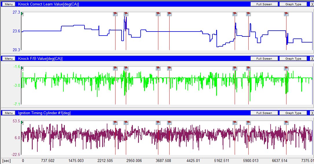

    sure, the timing will advance on High octane vs 87. But on stock ECU, 92 performance was pathetic. Those red vertical lines are pings that I heard.
    Tacoma ECU is not handling high octane well without modifications to Ignition, Knock , Valve timing
    Your cases could be different, but it was not worth for me to pay extra per gallon.

    i wonder why it still pings with higher octane fuel? i'm guessing ECU will just constantly advance the timing until it senses knock, then backs off a bit. the service manual even states some light pinging is normal under heavy loads.

    Interesting…..I’ve never heard any pinging

    it's not easy to hear it. you can see it pull timing in real-time with a OBD reader/scan tool though. it's very light pinging.
