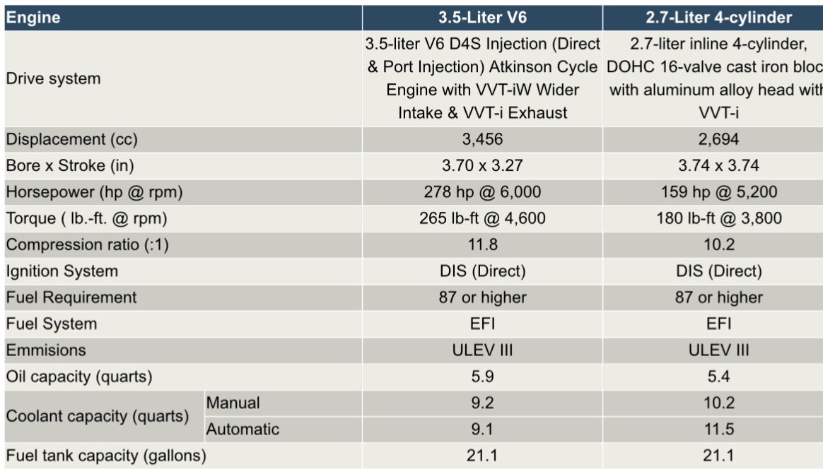

    I used 87 once in the 2012 I used to own, and it knocked heading up the mountain to get home. No more. Not at these compression ratios. Flat roads are okay with no load. However, put a heavy load whether it’s hauling or towing up a steep grade, fuck that. Top tier.
