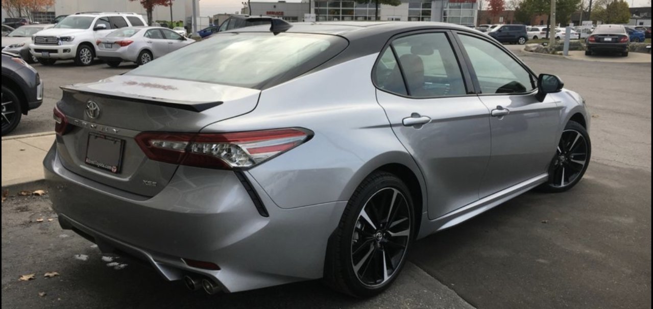

    You know Toyota detuned the Tacoma when this has 300hp+ with the same engine
