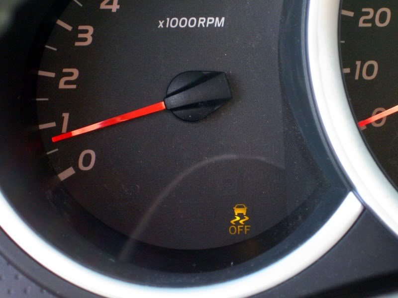

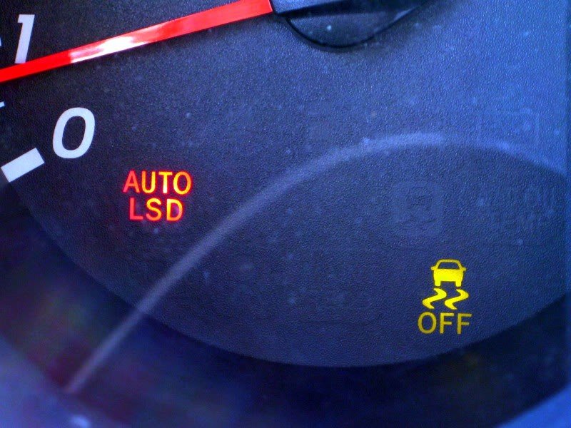

    Can you clear up your question for me, I am not sure what you are saying or asking of me? Let me take a stab at them, with photos:
    If you push once, it doesn't matter if you are in Park or Drive, moving or stopped.
    In H2 you will go into AUTO LSD (which is the same as TRAC OFF). I am surprised you have both lights coming on together. My 2010 does not have a TRAC OFF light. The VSC OFF light is on only to 30 mph, then goes off.
    USE AUTO LSD IF YOU HAVE TIRE SPIN when trying to move in H2.
    2012+ 4WD Tacomas have TRAC OFF with a button push in H4. 2009-2011 it is called TRAC but is the same nonregulated traction as TRAC OFF/AUTO LSD. No button to push (they didn't forsee anyone wanting the weaker TRAC in 4WD).
    If you stop moving and press and hold down for 3+ seconds (H2 or H4) you should have VSC OFF light... I NEVER USE VSC OFF (it makes my truck the same as my older one without traction control, ie. tires spin more). Toyota says to use VSC OFF to clean out tires with mud or snow. VSC OFF is also anytime you are in L4.
