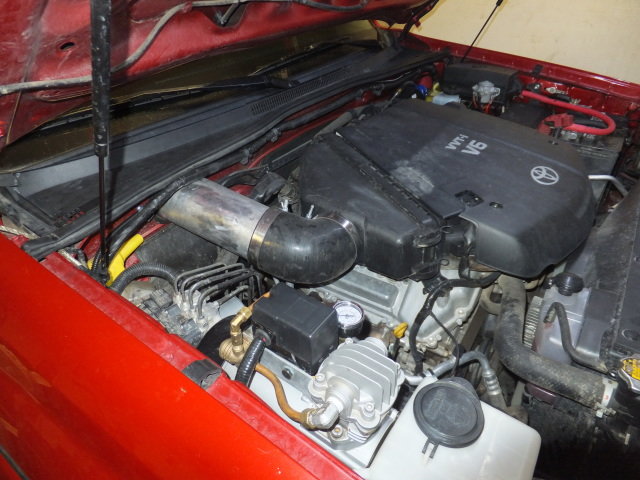

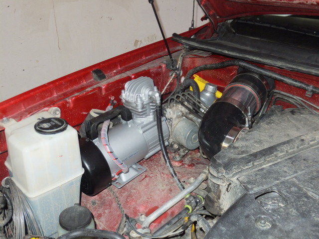

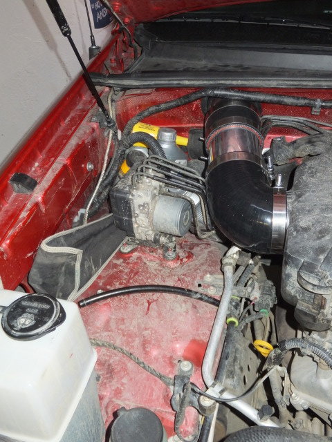

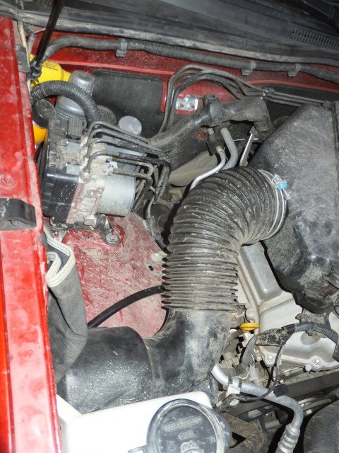

    Here's the stock engine bay:

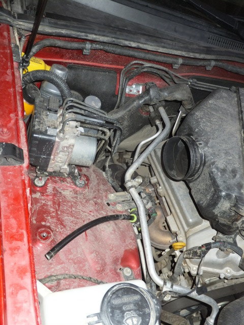

    Stock engine bay with intake tube removed:

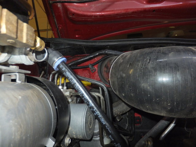

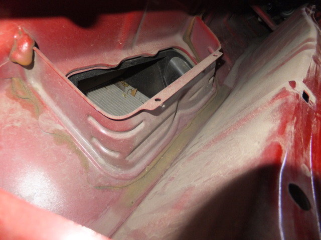

    View under the cowl:
    After cutting the hole (sorry, no pics. Possible I'll snap some when I remove everything to paint the bare metal I forgot to do), assembling the tube, and mounting it all up:
    You'll note that I have an extra coupler hose on there. That' temporary, as I was using off-the-shelf parts from Schlep Boys (a 6" and a 4" tube). I will be replacing the two-piece intake tube with a single piece of aluminum. The end result will be the 90* elbow and one long, continuous aluminum tube going into the firewall.

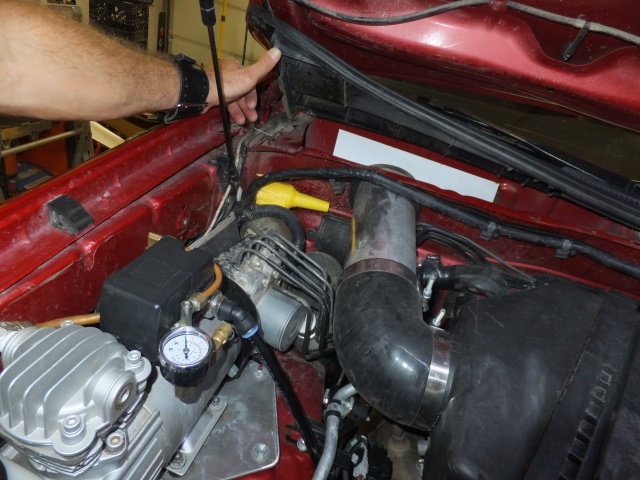

    Why I did it -- or -- The real estate I gained -- or -- Check out my bad-ass compressor:
    (The compressor is just sitting in there for display purposes. Nothing is mounted or hooked up yet.)

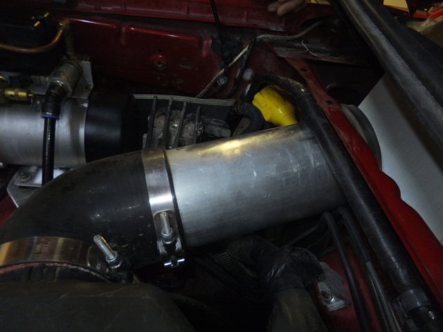

    Remove the intake tube. Loosen the 10mm hose clamp, unbolt the two 12mm bolts holding it to the wheel well. Remove from truck.
    Attach your new elbow to your new tube, so that it is now a single unit. Use this to test-fit where you will be cutting the hole in the firewall. Note that you will very likely need to push/bend the brake lines out of the way slightly, and also note that you will be working very closely to the brake lines when cutting the hole. Pretty sure I don't need to point out just how careful you need to be to avoid cutting the brake lines. Mark where the hole will be, using your preferred method of marking (X, trace a circle, dimple, whatever). Remember to allow for the thickness of the rubber donut!

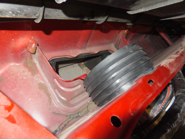

    Start cutting. Again, be careful with those brake lines! Remember to cut a SMALLER diameter hole at first, as you will need to do some cleaning up of the hole, and you can always enlarge the hole with a die grinder (but can't shrink it if you overcut). I used a Dremel with a cutoff wheel, then hit it with my die grinder to get it just right -- if you have a hole saw that's just the right size, use it.

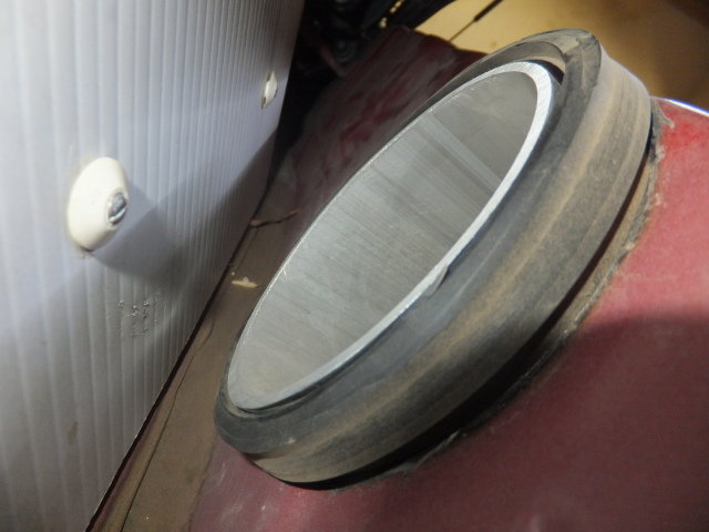

    Squeeze the rubber donut into the hole, adjusting the holes size as needed. It should be a nice tight fit. Now work the tube into the donut, making sure it's also a nice tight fit. Adjust the hole size as necessary with a die grinder.
    Once you're happy with the fit, and everything attaches well, pull everything out of the firewall and give the bare metal a coat of paint to protect it from rust (the one step I skipped as of this writing). Once the paint is dry, re-assemble everything, remembering to tighten the hose clamps.

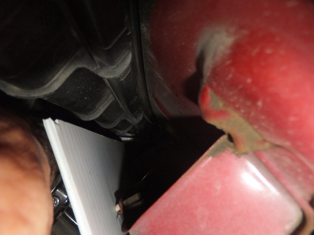

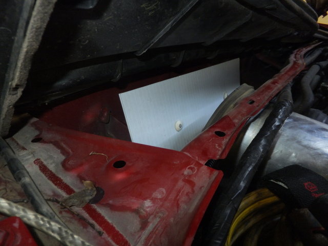

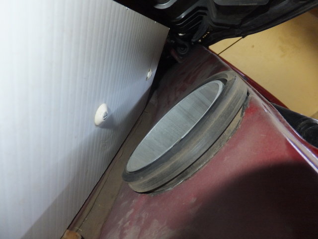

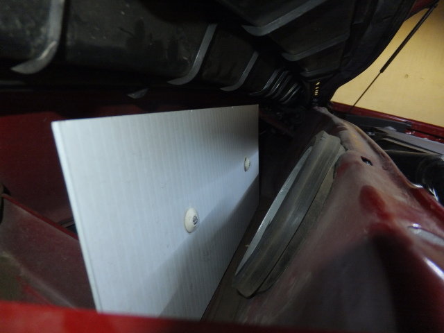

    Installed a simple, basic wall to separate the two intakes (engine/HVAC). Used rigid plastic board (think plastic cardboard), attached to the two stock holes on the HVAC intake (bent up to be flush with the rest of the wall......see pic #5) with a couple of plastic removable rivets. All parts I had sitting around already.
    I also trimmed the donut shorter, so that I have more clearance between the two intakes.
    While I've only driven a single one-mile roundtrip since doing it, I suspect it made a difference. I seem to have less drop in airflow in my HVAC when I'm at WOT. In fact, it seems like I have *increased* airflow in my HVAC when I'm at under-40% throttle, improving upon the stock cabin-air intake pressure.

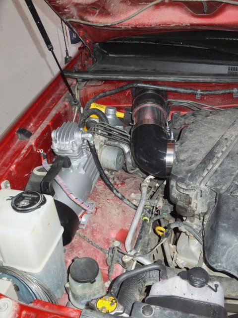

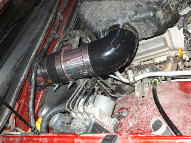

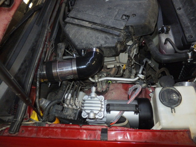

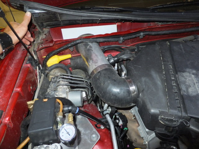

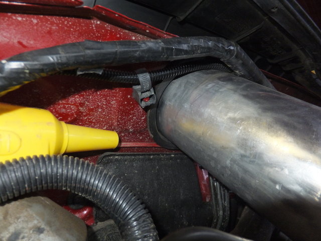

    Final install pics!
    These were shot tonight, as the final version of the project. I've put about 8,000-10,000 miles on this setup with not a single complaint or problem.
    The solution to the drop in HVAC air when opening the throttle up is to turn on the RECIRC mode.
    You'll note the intake pipe I'm using is a bit ...uh...thick (.180" wall??). If I had to do it over again, I'd get **MUCH** thinner tube! Meh, oh well. It works. And it can probably stop bullets. Pretty sure this is the FleaBay seller I got it from. I bought only one foot, since the total I needed was only about ten inches.

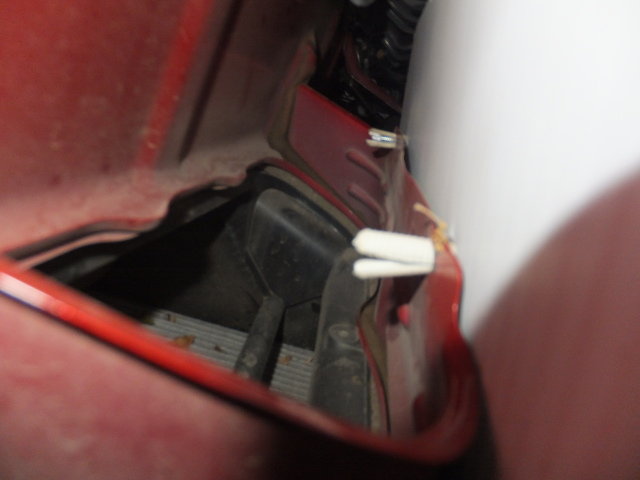

    Sorry about it being upside-down. One of the most awkward angles I've ever had to hold a camera and still reach the shutter button.

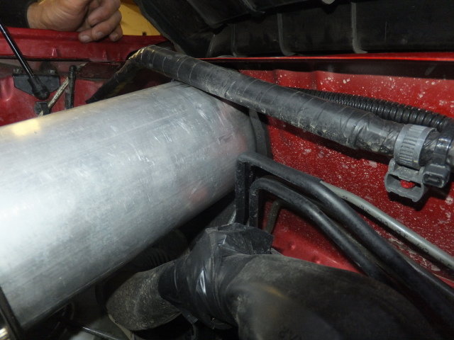

    This is looking from the other side of the HVAC intake -- camera is placed roughly at the centerline of the vehicle, pointing toward the passenger side.
    Even after gently bending the brake lines out of the way, it's still a tight fit (yes, they touch).

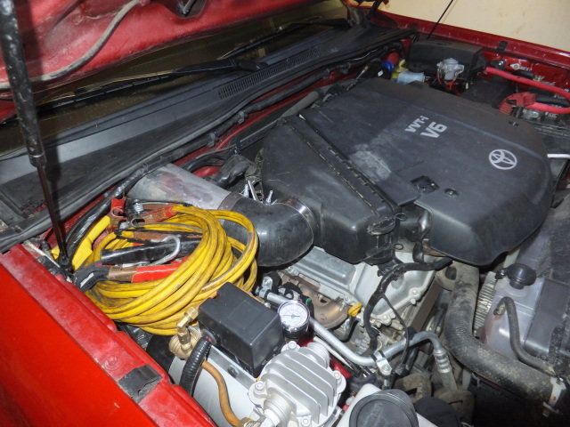

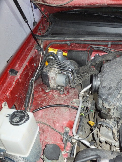

    A good shot of how my engine bay looks right now, minus the jumper cables.
    Exactly how my engine bay looks any day of the week, jumper cables, air chuck hose, extra oil bottles, tow strap, roll of duct tape and roll of foil tape, bailing wire, spare tire tools, and all.
