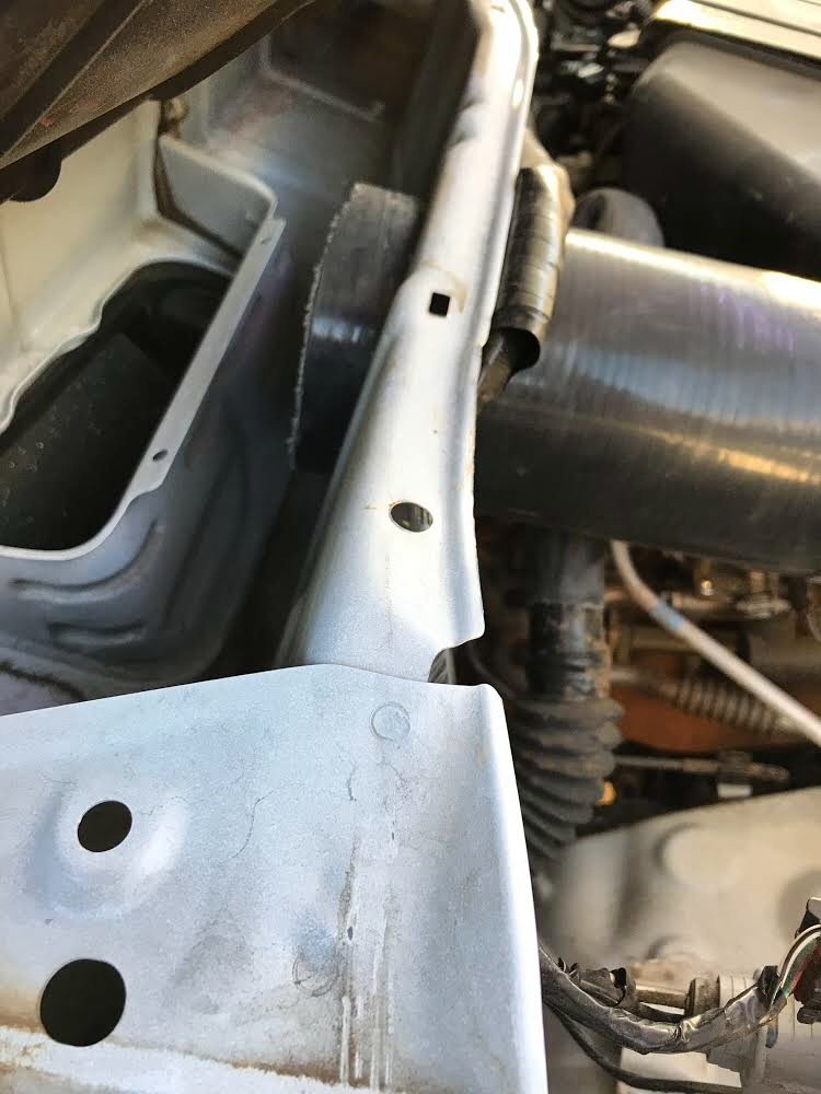

    Updated redo, don’t like chrome so bought a 4”x12” silicone coupler and cut it to length and slide it over the chrome intake tube.D8954A86-F441-4D01-A208-1B1DF76A1491.jpg 4E4FF1B9-C073-4167-A26F-3CAEB43ADA83.jpg

    Looks good.

    [​IMG] [​IMG] [​IMG] [​IMG]
    took a few pis today of mine. i ran this for about a yr before my truck went out of commission due to an collision.
    4" to 3" pipe. fuel hose and black RTV . worked flawlessly, minimal extra noise from engine and no other signs of change in air flow from before the install. some others mentioned ac air flow problems so i paid close attention to that before and after seemed the same. maybe due to 3" vrs others ran bigger, not sure. but it works its a clean install, and no big dorky snorkel for people to laugh at. My wife isn't a fan of the dorkle look as many people feel the same way. myself i could care less on looks as long as it works, and dosnt break the bank.
