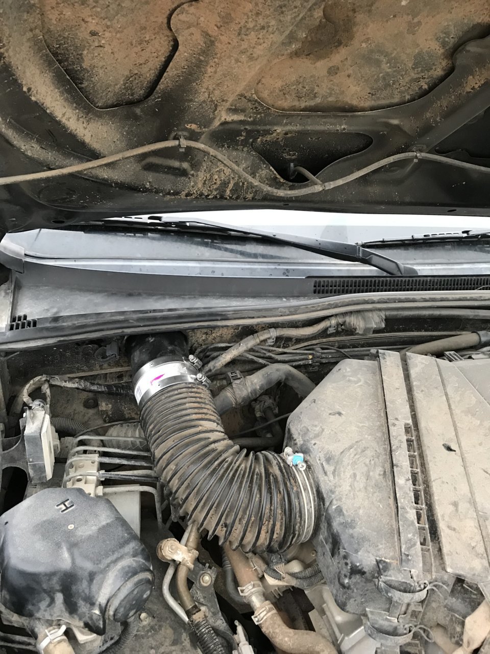

    Reviving this thread for a sec... Decided to do this since I trimmed for 35s and didn’t really want a snorkel.. here’s my outcome. $12 solution reusing the stock intake tube turned over and cut off enough for a rubber coupler at the last flat straight surface of the tube. 5” of 3” pvc (painted), rubber clamped coupler and door trim lining for the cut hole. Turned out awesome, thanks for the write up and ideer032F05FD-B450-4069-8F42-8606D981274C.jpg

    I like that door trim idea. I think I'm gonna add that to mine for a little more snugness through the cowl hole

    Yeah it was a very snug fit. I had to pull the trim out a little and push the tube thru to get the trim to roll onto the edge and sit correctly. Worked out perfect though. Gonna make an a/c intake divider like the OP did in the next few days when the weather is better.
