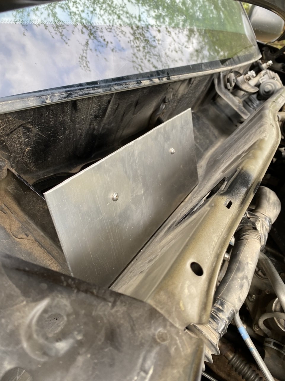

    Has anyone cut a hole or holes on the side of the cowl to give a little more air to the system since it is being used by the hvac and engine?
    If you have photos of it please share as i'm contemplating doing it to have assurance i'm supplying enough air to the engine and cab.

    I did.
    Following this ⬇️
    https://www.tacomaworld.com/threads/cowl-induction-snorkel.525314/

    138
    SoCal
    2006 Silver Tacoma Long Bed
  14. Jun 2, 2020 at 5:23 AM
    #334
    deekyn
    deekyn Well-Known Member
    Dec 23, 2015
    #172953
    1,762
    Dustin
    Yellowstone
    2015 Black Tacoma TRD Off Road
    Both sides. I didn’t run it without the extra holes, so I can’t compare with and without. No issues that I can tell. Sound in the truck is a little different with the cowl intake mod. A little throaty on acceleration. Which I notice since I’m running 34s on stock gearing. But with my roof racks (which are already loud). The wife actually likes the sound. Win win

    Hey hey, OP checking in here. Stopped by to grab the link for a FB discussion, figured I'd see what y'all have been doing with this thread.
    Deekyn- How is the fresh-air HVAC flow on high fan while under WOT? Do you notice any drop in flow?
    Since you opened up the cowl before running it closed, you don't have a before-&-after comparison. But you should be able to weigh in on how the HVAC air is doing.
    If you don't see a drop in HVAC flow, then I think you came up with a solution to really the only issue this mod has. I may try doing that myself.
