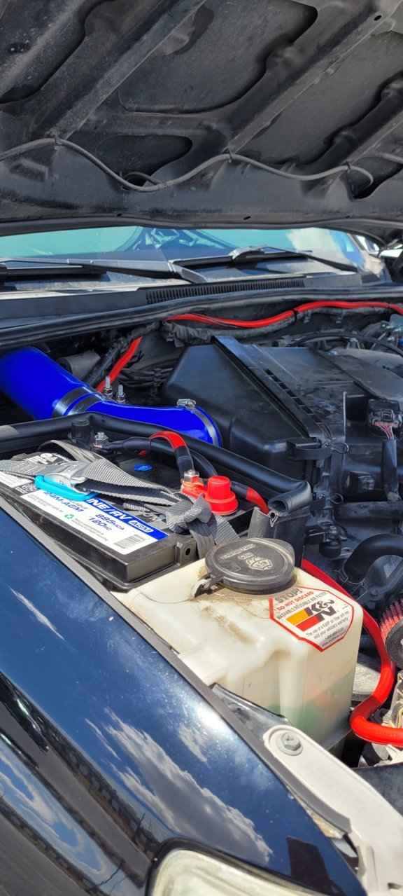

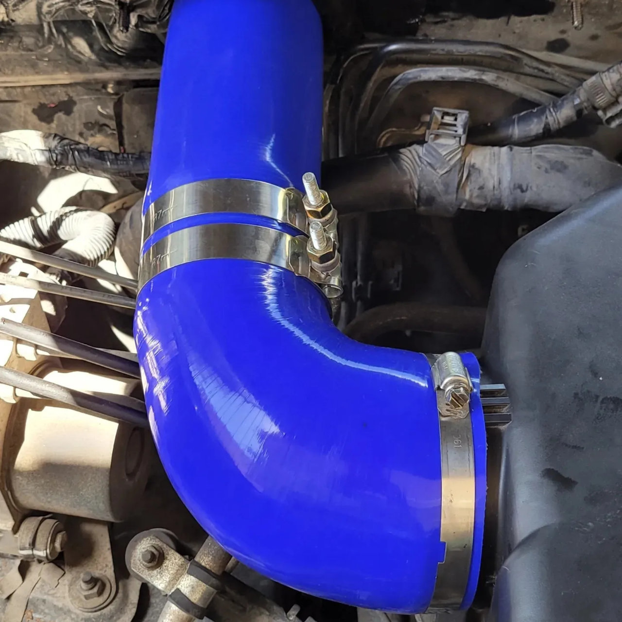

    my parts came in and I went this route instead... A lil more pliable and a bit cooler air. Probably because the wrap job on the other one was trapping heat?? Anyway, finished, satisfied, and almost done with 2nd battery set up in that very empty space..

    Where did you get the blue ducting? Can I get a parts list?

    I've been wanting to do this for a while but glad I waited. I think your configuration is the best one I've seen so far. Very curious to know more details.
    ^^^THIS, @Dvst8r1K please share your parts list if you can. Or Also can you show / describe what you did for the firewall area? Did you use a bulb seal or just edge trim?

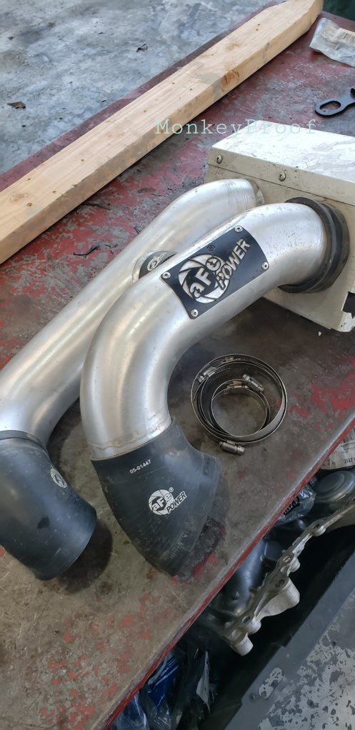

    After years of "I probably should do this" I finaly did it!
    Came across this 3.5L Ecoboost Cold Air Intake system from a buy back( all buy backs have to go back to 100% stock before resale). I offered it to anyone who wanted it in the LongTravel Thread a few months back, but nobody was too interested.
    And just about when I was going to scrap it, I said I bet I can make this work on my own junk
    So here it is.. took the longer tube and elbows for myself and scraped the rest of it

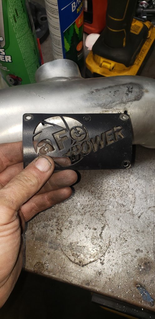

    Removed the Logo from the discarded tube..

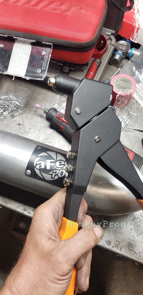

    And installed it on the good tube, a good ol' 10 dollar harbor frieght rivet maker was the most appropriate tool for the job. The Logo is money..
    Cut to kinda the appropriate length, plugged up a small hole, ground off some excess material and its like it was made for my junk straight from a factory..
