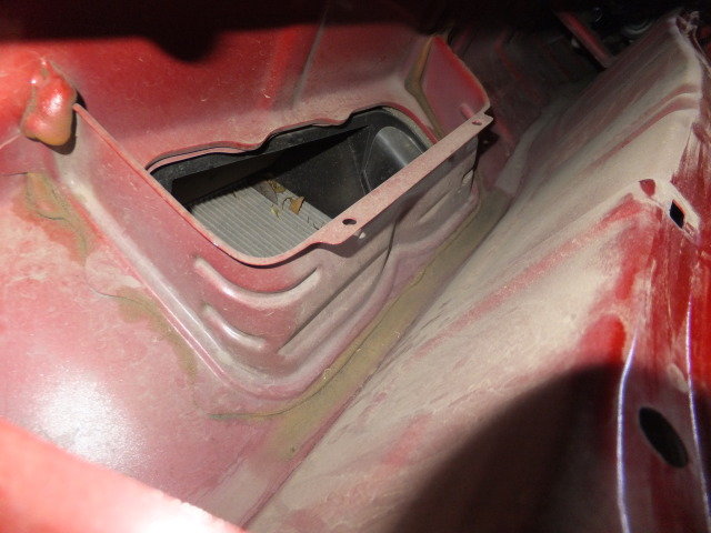

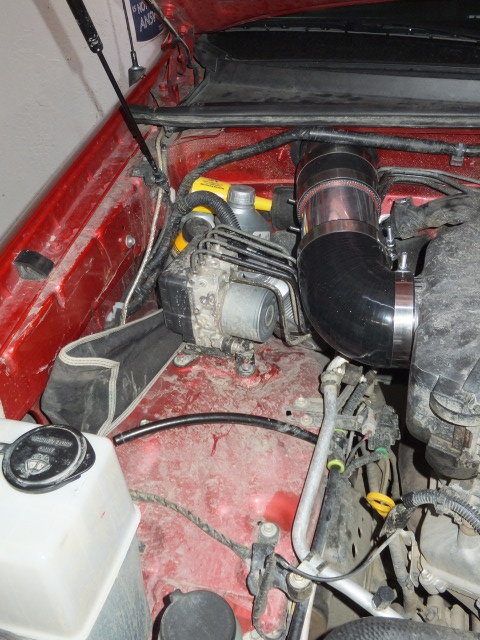

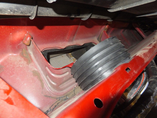

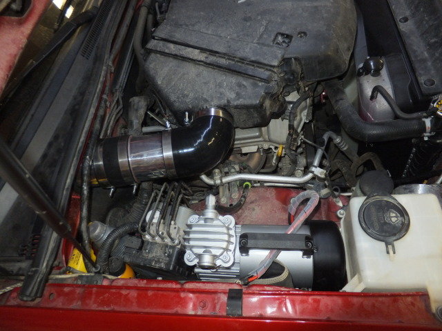

    Got it in today. Piece of cake.
    Took me about three hours, 2.5 of which was me tweaking out on getting the hole juuuust riiiight.
    Parts needed:
    * 4" ID 90* close elbow ("close" = one leg is just long enough to fit a hose clamp)
    * 4" ID x ~12" long metal tubing (ahem, aluminum)
    * 4" rubber "donut" for mounting clay pipe (Homey Despot SKU #143-175: PlumbQuik part number P44U-405)
    * two hose clamps for the elbow (4"ID)
    * a few dabs of paint
    Tools needed:
    * 10mm socket or #2 phillips screwdriver
    * 12mm socket with long extension
    * your choice of tools for cutting a 4"++ hole in sheetmetal (hole saw, Dremel, files, die grinder, whatever tickles your fancy)

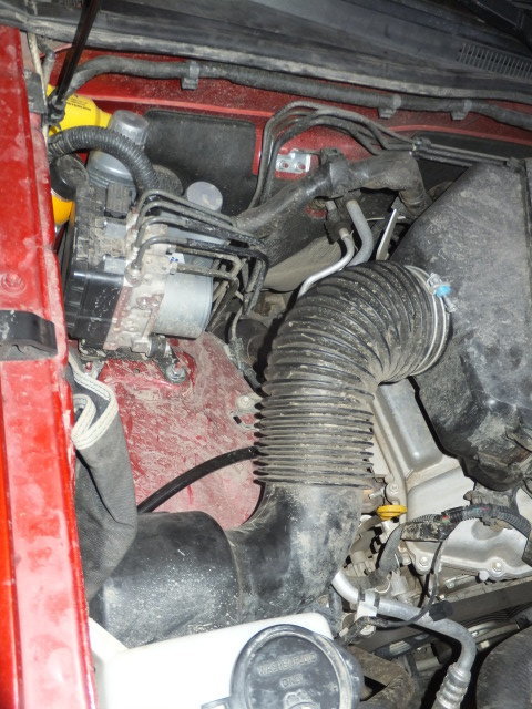

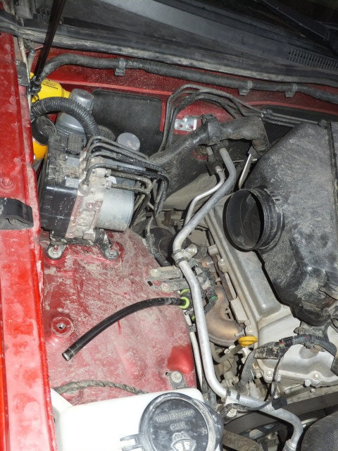

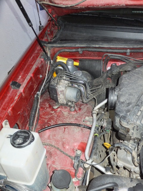

    Here's the stock engine bay:
    Stock engine bay with intake tube removed:
    View under the cowl:
    After cutting the hole (sorry, no pics. Possible I'll snap some when I remove everything to paint the bare metal I forgot to do), assembling the tube, and mounting it all up:
    You'll note that I have an extra coupler hose on there. That' temporary, as I was using off-the-shelf parts from Schlep Boys (a 6" and a 4" tube). I will be replacing the two-piece intake tube with a single piece of aluminum. The end result will be the 90* elbow and one long, continuous aluminum tube going into the firewall.

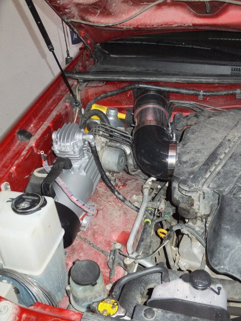

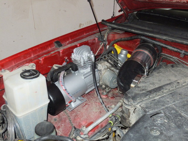

    Why I did it -- or -- The real estate I gained -- or -- Check out my bad-ass compressor:
    (The compressor is just sitting in there for display purposes. Nothing is mounted or hooked up yet.)

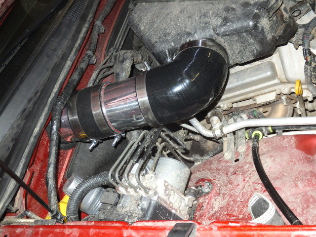

    The procedure:
    This is really simple enough I shouldn't need to explain it. If you're comfortable cutting the sheetmetal of your truck, you probably don't need me explaining how to do it.
    Remove the intake tube. Loosen the 10mm hose clamp, unbolt the two 12mm bolts holding it to the wheel well. Remove from truck.
    Attach your new elbow to your new tube, so that it is now a single unit. Use this to test-fit where you will be cutting the hole in the firewall. Note that you will very likely need to push/bend the brake lines out of the way slightly, and also note that you will be working very closely to the brake lines when cutting the hole. Pretty sure I don't need to point out just how careful you need to be to avoid cutting the brake lines. Mark where the hole will be, using your preferred method of marking (X, trace a circle, dimple, whatever). Remember to allow for the thickness of the rubber donut!
    Start cutting. Again, be careful with those brake lines! Remember to cut a SMALLER diameter hole at first, as you will need to do some cleaning up of the hole, and you can always enlarge the hole with a die grinder (but can't shrink it if you overcut). I used a Dremel with a cutoff wheel, then hit it with my die grinder to get it just right -- if you have a hole saw that's just the right size, use it.
    Squeeze the rubber donut into the hole, adjusting the holes size as needed. It should be a nice tight fit. Now work the tube into the donut, making sure it's also a nice tight fit. Adjust the hole size as necessary with a die grinder.
    Once you're happy with the fit, and everything attaches well, pull everything out of the firewall and give the bare metal a coat of paint to protect it from rust (the one step I skipped as of this writing). Once the paint is dry, re-assemble everything, remembering to tighten the hose clamps.
    The whole project as you see it in the pics cost me about $60. That will be dropping once I exchange the two aluminum tubes and the coupler (and clamps) for a single aluminum tube......I suspect the final bill will be about $30.
    If you want a good source for the elbow and T-bolt clamps, let me know. The 4-ply silicone hose cost me $15, and the T-bolt clamps were $4 each.
    My notes thus far on performance:
    I drove about eight miles between finishing it and posting here. It was on a surface street commonly used as a bypass for freeway traffic, and it was during rush hour......and with one lane closed. Suffice it to say, I didn't get a good variable experience. I did get to mash the throttle some.
    Noise: Not noticeably higher. I do sense a low growl when accelerating, but nothing of any particular note. Cruising and WOT don't seem to have changed at all.
    Intake temp: No static change -- it still reads about 10* more than ambient. What I did notice was that the dynamic change improved, with the cool-down period after heat soak being significantly faster -- what I mean is that when sitting still, the engine heat tends to soak into the intake, causing the intake temp to soar as high as 50* more than ambient, but when moving all that soaked-in heat from sitting dissipates much faster to return the intake temp back down to ~10* over ambient. At some point I will likely put in some kind of heat shield along the bottom.
    Airflow: I have gotten just a bit more vacuum, from ~23 inHg to ~27 inHg. I interpret this as better airflow.
    Butt-o-meter horsepower: No change. I can't tell if I gained an extra 2,000 horses, an extra .002 horses, or things stayed the same. My butt's just not sensitive enough.
    I will weigh back in on whether there is any effect on cab ventilation. Likewise with low-end power and upper-end power.

    Yeah, I fell asleep with the computer in my lap last night. Was going to post a bit more......
    I designed/built it with the idea that I will be fine-tuning it as time goes on. Now that I see there is a small noise issue, I will be addressing that.
    First thing I'm going to do is shorten the rubber donut that mounts the tube through the cowl -- that will give me about 1.5", and likely help with competing air demands between the intakes.
    I'll also experiment with various ways of building a wall between the two intakes (engine and cabin). Probably start out with some soundboard pieces I have sitting around, probably end up with a formed sheet of aluminum with DynoMat on either side (or dipped in tar) -- I don't have the space to mount a turndown/out.
    The available cubic inches under the cowl are more than enough for both intakes. It's just a matter of figuring out how to get the two to stop fighting for each other's air.
    I didn't mention this before, but I think it's worth pointing out. The tube is only slid into the rubber donut. I have no plans to attach them together, such as with caulk. This is very intentional, as I want to allow as much movement as possible between the engine and the body. It also helps with removing the intake, or accessing the filter.

    Is there enough room to put another 90* in the cowl area and send the intake pickup to the driver side? This may help with noise (getting it away from the filter) and the competition for air.
