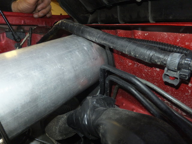

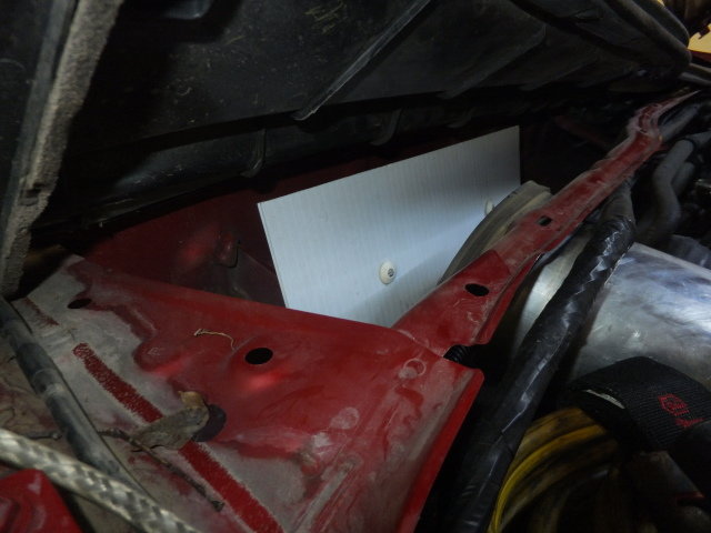

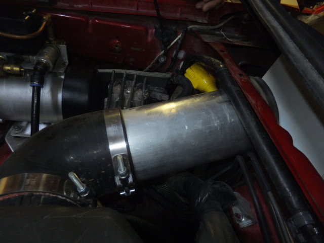

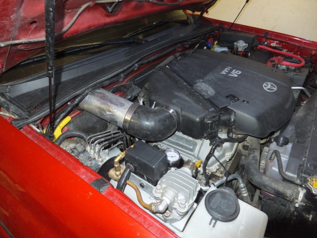

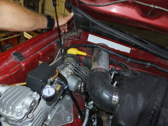

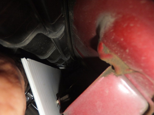

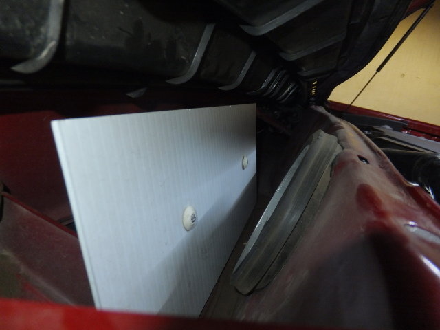

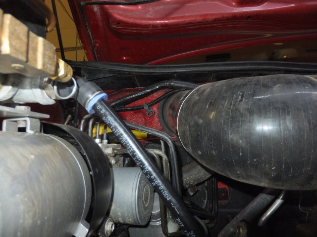

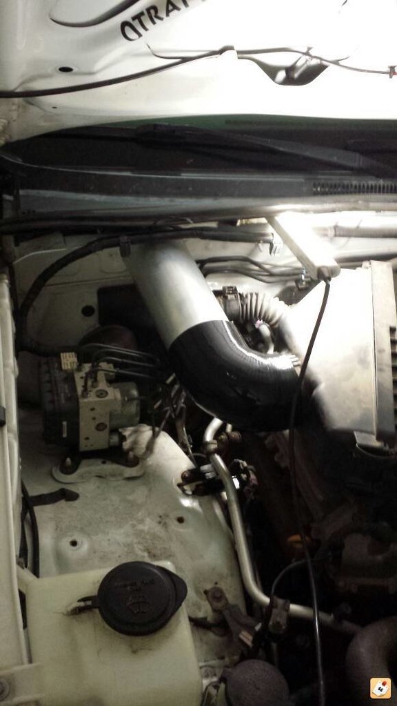

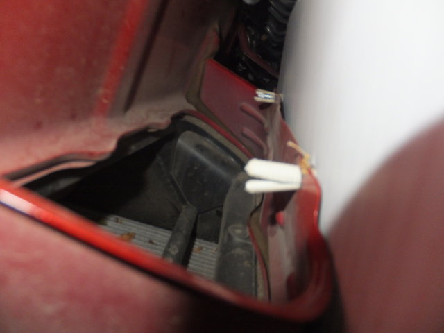

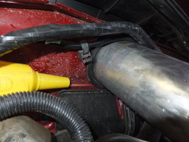

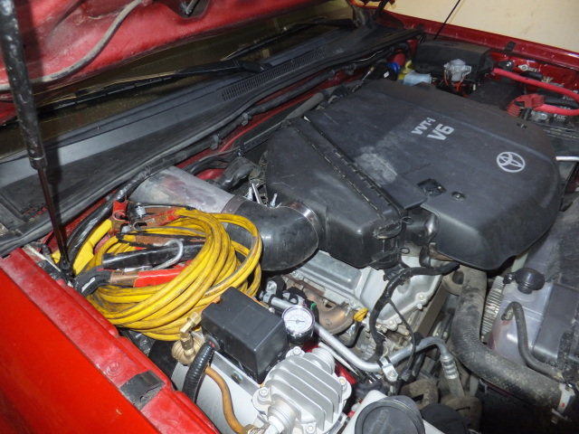

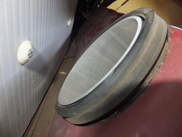

    Final install pics!
    These were shot tonight, as the final version of the project. I've put about 8,000-10,000 miles on this setup with not a single complaint or problem.
    The solution to the drop in HVAC air when opening the throttle up is to turn on the RECIRC mode.
    You'll note the intake pipe I'm using is a bit ...uh...thick (.180" wall??). If I had to do it over again, I'd get **MUCH** thinner tube! Meh, oh well. It works. And it can probably stop bullets. Pretty sure this is the FleaBay seller I got it from. I bought only one foot, since the total I needed was only about ten inches.
    Sorry about it being upside-down. One of the most awkward angles I've ever had to hold a camera and still reach the shutter button.
    This is looking from the other side of the HVAC intake -- camera is placed roughly at the centerline of the vehicle, pointing toward the passenger side.
    Even after gently bending the brake lines out of the way, it's still a tight fit (yes, they touch).
    A good shot of how my engine bay looks right now, minus the jumper cables.
    Exactly how my engine bay looks any day of the week, jumper cables, air chuck hose, extra oil bottles, tow strap, roll of duct tape and roll of foil tape, bailing wire, spare tire tools, and all.

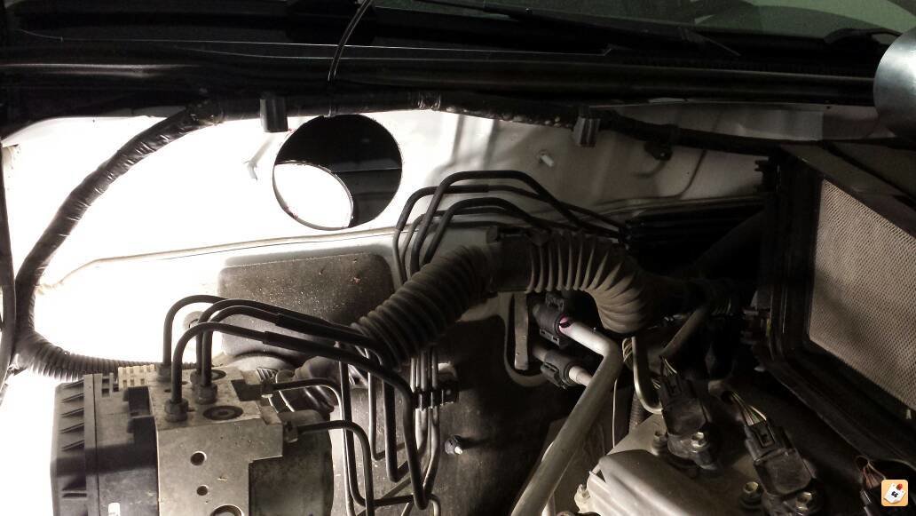

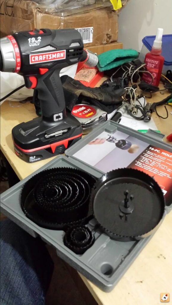

    I finally got around to starting this.
    I picked up this set at Northern Tool for $10. I had no trouble cutting through the firewall with my 19v lithium.
    I need to enlarge the hole and get the pipe rubber fitting for the firewall.

    Lookin' good man!
    The proper size hole saw does make it much easier, with a finer final look. Better than my Dremel method.
    So what did you think? Easy? Hard? Just the way I described it, or way off base? Just curious what others' experiences were.

    The hole saw went through like butter. I saw people online put some cooling grease on so I put some grease (red and tacky) on the blade.
    I didn't have to bend the brake lines but I did cut down the 90* to give it a better angle. I still need to put in a divider. Yep pretty much like you described it.

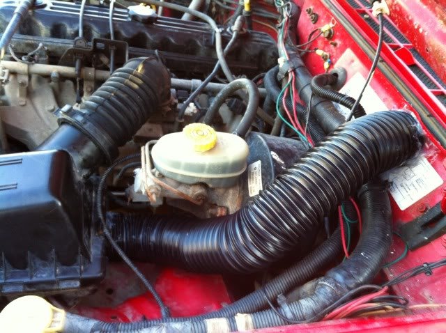

    Bilstein 5100's set at .85, OME 885x coils w/ 1/2" top plate spacers, Total Chaos UCA's, Wheelers 1.5" HD 3 leaf progressive AAL w/ factory overload leaf, DT Pipe Bomb Ypipe, Vibrant resonator, Magnaflow pro series catback system, URD Short Throw Shift Kit, Debadged, BHLM, BTLM, 6000K BiXenon Headlights & Fogs.
    This is a pretty common mod in the jeep world I made one for my old Cherokee that worked awesome. So happy to see this on the tacos as well. Will most likely do this to the taco as well. Nice work!
    What it looks like on a 4.0 jeep.

  19. Dec 21, 2013 at 10:29 PM
    #99
    Mach375
    Mach375 [OP] Habitual Violator of Wheeling Rule #2
    Sep 18, 2010
    #43428
    2,170
    Sathington "Alowicious Devadander Abercrombie" Willoughby (but you can call me Mud)
    Location: Satan's Stinky Butthole (SoCal)
    '11 DCLB 4x4 TRD Sport
    Too much to list, but enough to get me in trouble. Repeatedly.
    Boner-killer right there. That shit is FUGLY.
