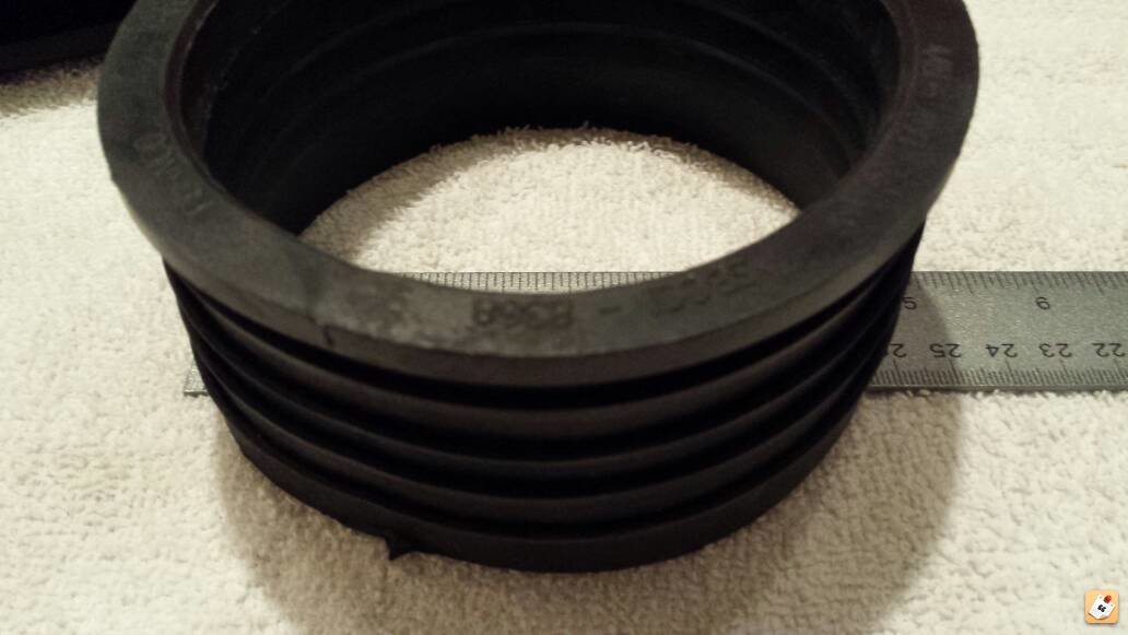

    I collected all of the parts and ordered the elbow and alum tube. If they are in today, I will have my weekend project. The ebay listing for the tube does not exist anymore, but here is the website I ordered from. They have 0.065" tube, which is good because the op suggested using thinner than the 0.120" tube. Still 4" o.d.

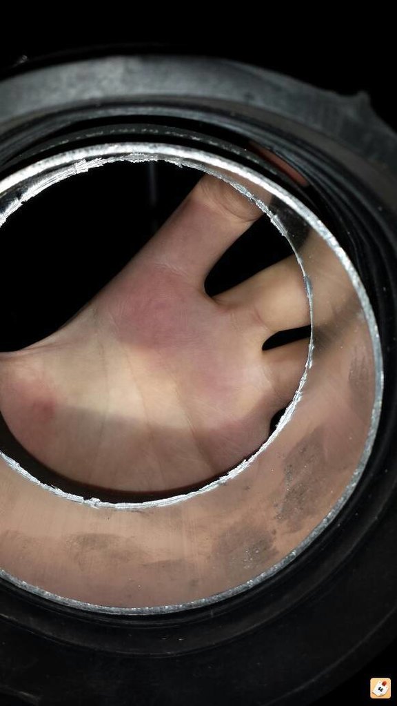

    The only thing I wish I did different was measure your final diameter before cutting the hole. I drilled a 4" hole and spent a lot of time dremeling in it wider.

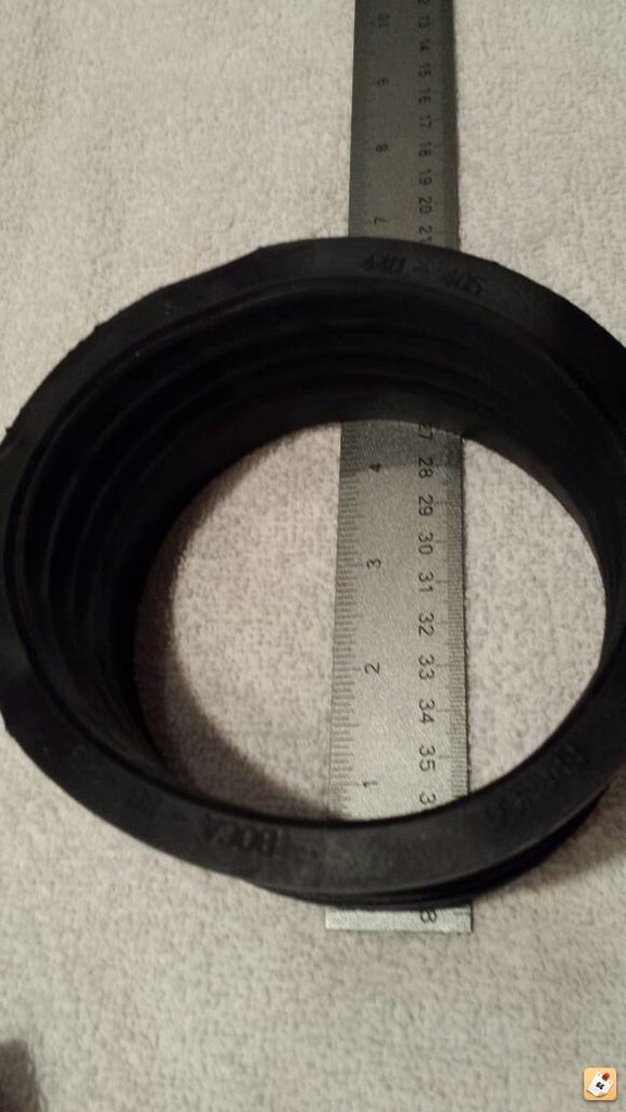

    Good to know. I have a 4" hole saw, but I'm not sure if it is o.d./i.d. I have some carbide bits for a die grinder that worked well on my frame. I am hoping they will eat through the firewall quick enough... Once I get a chance to measure the donut, maybe I can find a larger hole saw at home depot.

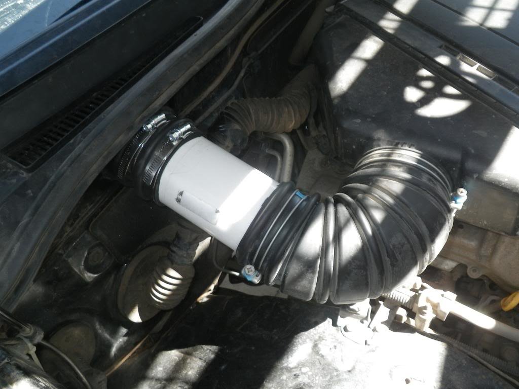

    4R version, used the stock intake for most of the parts, and used a piece of PVC for now, if it seems like it is getting too hot I will swap with AL, total cost: $7. One cool thing I did was by using the stock pieces, I retained the scoop which would prevent any water from the top getting sucked in.

    Keep in mind it's a whole lot easier to make a small hole bigger than to make a big hole smaller. I suggest erring on the smaller side, and spend a little time fine-tuning the size with a die grinder or dremel or file.
