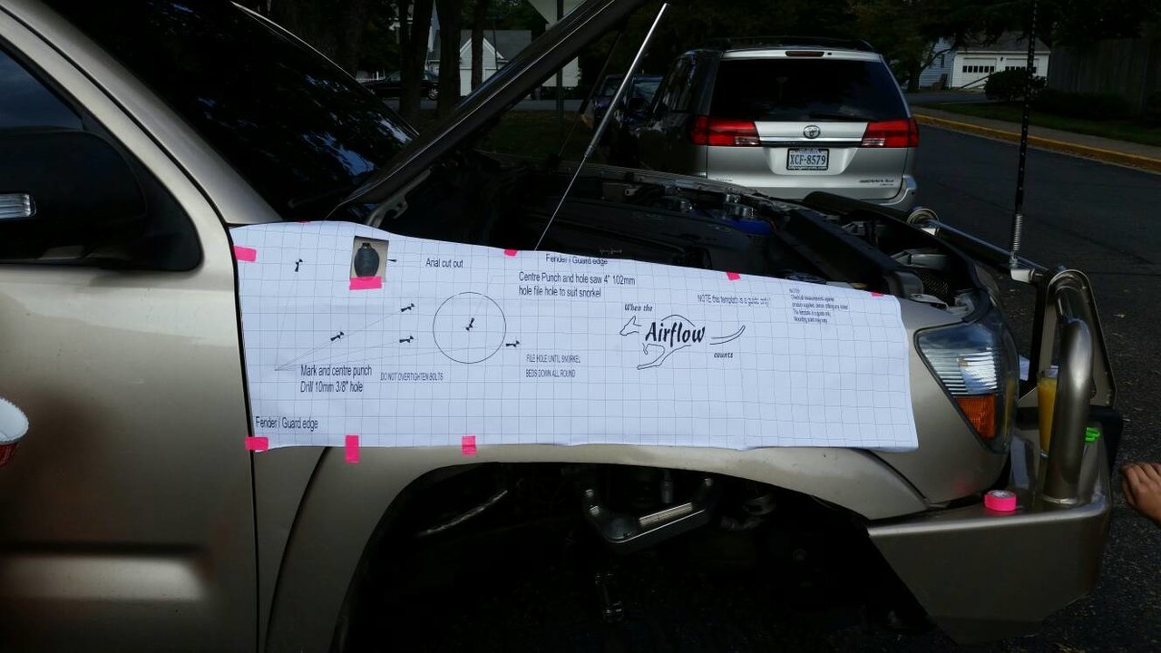

    You turkeys.
    d3592a35c50409be013dde2db6b3c7ad_41049a0fd0554183f32815ed88df98acfac28a48.jpg313100458e35b780c003b296fb0bd1b2_f6ae1c2c41398f7ddd5434ddf97b8b084f1f10b4.jpg97d5e2dbf11d51c9b93c5c2898c0e49e_9077507c44041af83bf3cc340b24c5684edb26ff.jpgc77b323a6d598283efa7323c38ef4f22_ef4bfbdfb0d94fabe4fd22341d5e724c18d3f265.jpgbcf02f56cdb652f2b79a6ec94bfa51d0_7350787b4e12d58284cbf0061e55260bc411cdc5.jpgfce309114e28c087f00edb13750b2b7d_a014f64906a040b6d95deb8e060a36b3920682d9.jpgff9f686ee3d9296b87bcf72d725947e9_6b77a96b24aafe60f76e7132f25a62472ca8c616.jpg
    Just a teaser for you all.

    Haha this guy! Looking good!
