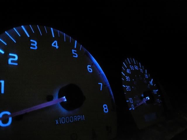

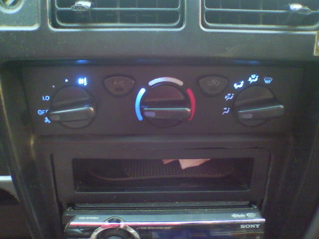

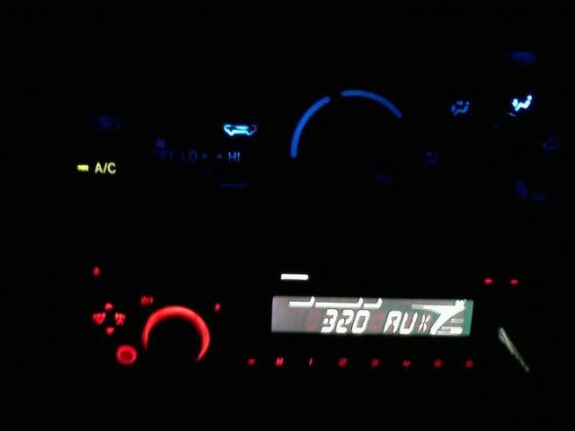

    I would say option 1 but good luck fitting a 360 in the ac panel...but i would say the cool white and no its not to bright to me but it will be at first untill you get used to it...the first time i did this i did red which looked still kind of orange to me so i went to white and decided it blended with the white background a bit much so now im at blue for my ac and cluster and i like it!
    Night time:
    daytime shot:

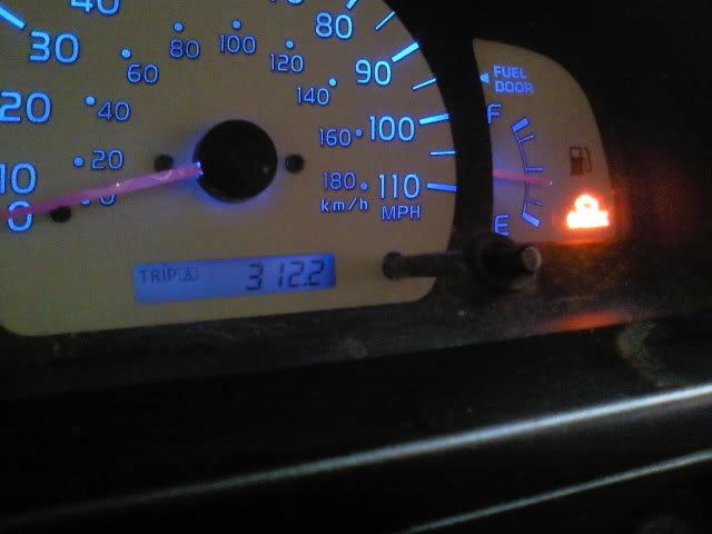

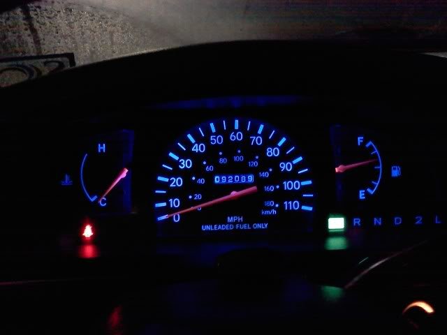

    Mine in my truck.
