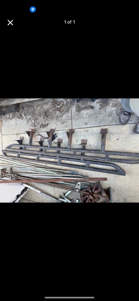

    Hey guys,
    Found some used sliders and was curious if they’d fit a 2019 TRD OR DCSB. The seller said the sliders are 05-15. He has a 2nd gen DCSB. See photo below. Thanks for the help.

    ^These sliders require drilling holes in the frame on either gen. Are you set up to do that?
    You may also need to fabricate a bracket to relocate the fuel pump controller, as it occupies a spot that was popular for one of the slider legs.

    You just saved me a headache. Not set up nor did I want to have to do that.
    Thank you for the heads up!
