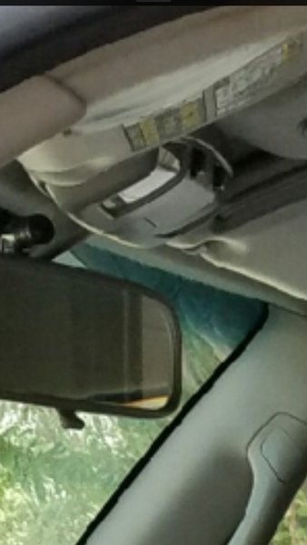

    I'm purchasing a pair of Limited seats off of a Local guy and in one of the pictures I noticed he had a different rear view mirror. It appears there are map lights. Mine is not like this. I believe mine is glued right to the window. Can anyone confirm this is true? (I'm not home right now so I cant look at the mirror to see if it's attached to the headliner or window)

    Yes I guess it was a option or upgrade to a different trim level. I have had two 1st gens and both had the map lights

    My 04 has that setup, Rear view clips to the map light housing

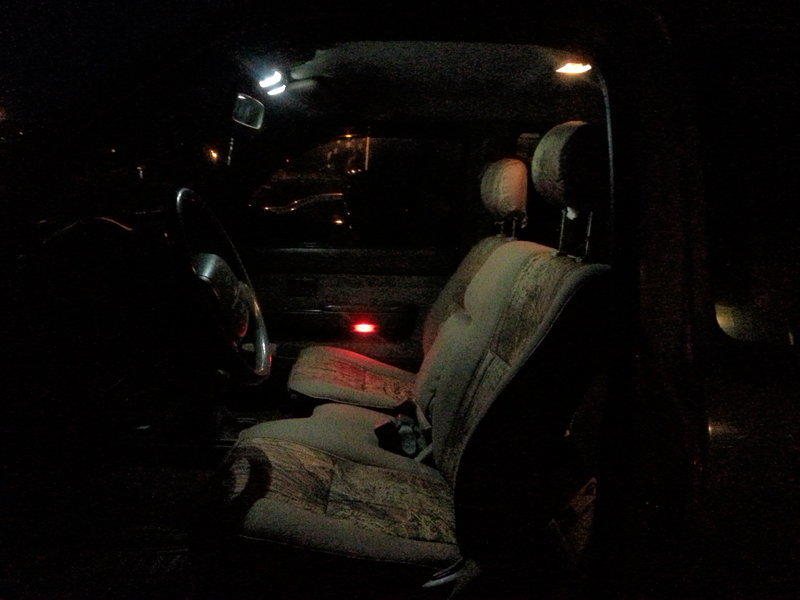

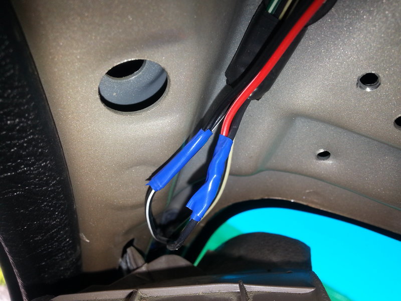

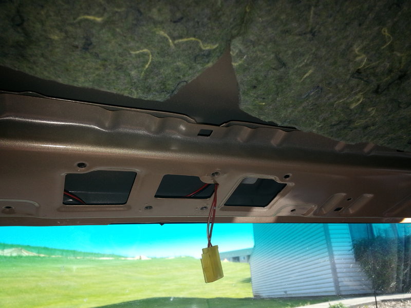

    I just did the same thing in my '98 that originally had a rear view mirror with no map light. Mine was also from a 2nd gen 4runner (a '94 I think). Wires for the dome light run along the edge of the headliner on the diver's side then down the A-pillar. The top driver side corner of the windshield is where I tapped into mine.
    All required screw holes were present under the headliner and the connector in the second picture came with my 4runner map light. I also replaced the original incadescent bulbs with LEDs to really get the most out of my new lights. Best interior mod I can say I've done. Finding stuff at night is way less difficult now that I don't have to pull out my phone and wave it around the cab with the flashlight on.
