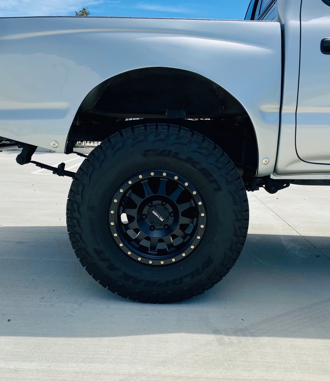

    I have a set of Deaver J59's. They hardly hold any weight and if you think it's going to be a nice, plush ride, think again. It's still going to be a bumpy ride. Our trucks are very light compared to a heavy Tundra. I recommend adding some weight in the bed.
    Here's a couple of pics of the Deavers.
