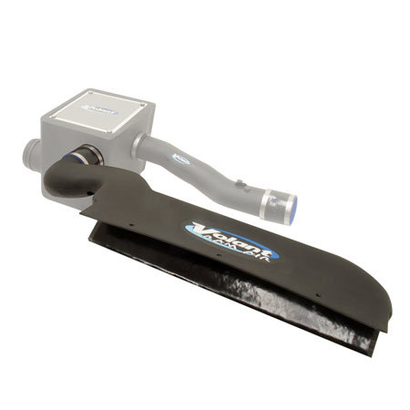

    Which Volant air ram scoop did you use? There are several versions to pick from. There is even one for our Tacomas. But from your pics you didnt use the tacoma version.

    Came off of a Tacoma. Again, bought it used, but fits the Tacoma's push-pin holes on the top rail. I have no reason to believe that it's not the Tacoma version.

    It looks like its meant for the Taco just that yours looks different than whats on the volant website.

    I just did a google image search and the picture you posted is the I4. I guess there's a version for each engine.. maybe..

    nevermind. further investigation looks like their the same and the difference you're seeing is the angle or something. take a look if i post these pics right.

    This is what I have...
