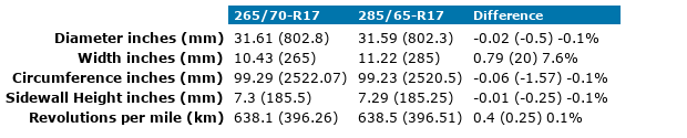

    You can run *wider* tires in the back than the front. But you need to take care they're the same *diameter*
    285/70R17 s both *taller* and *wider* than 265/70R17.
    You could do: 285/65R17 in back and 265/70R17 in front - assuming of course that you'd made any necessary alterations for the tires to fit. (e.g. removing mudflaps)

    Thanks for this ^
    I "toyed" with the idea of running the bigger tire in back simply to see how it would look in comparison as well check for clearances. Since it's not realistic to just swap tires back and forth on the wheels a bunch of times, I would've had just the back done until I decided on when and how to lift my truck. Based on this, though, it seems the tire being of larger diameter out back would potentially be a problem. If nothing else, now I know. Thanks!
