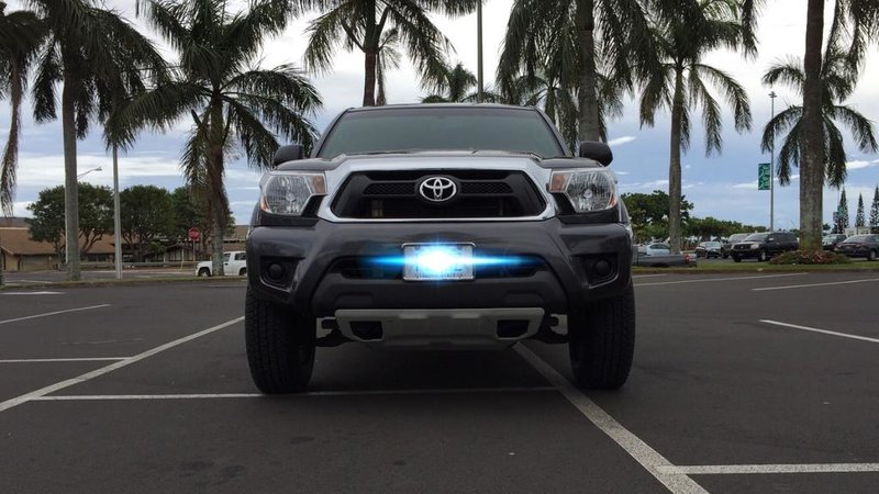

    Yet another one of Toyota's TRD accessories.

    Island Cruiser
    Island Cruiser TVita
    May 20, 2012
    #79166
    3,937
    Kauai
    Baja
    Kukui Grove action

    Speaking of this a friend of mine just got a TRD Sport, brand new, and was able to haggle a TRD skid plate out of them. FTW!!!

    ^^^^Beautiful!!

    except for the mis-matched 5k and 3k lights :)

    What's the problem? Aren't you into the pseudo Japanese Domestic Market look?! ;) :D

    Lol you know it!

    Lol way better shot than Uncle Ronald's parking lot
