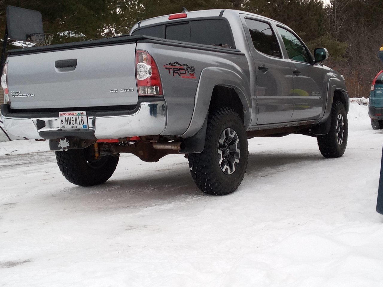

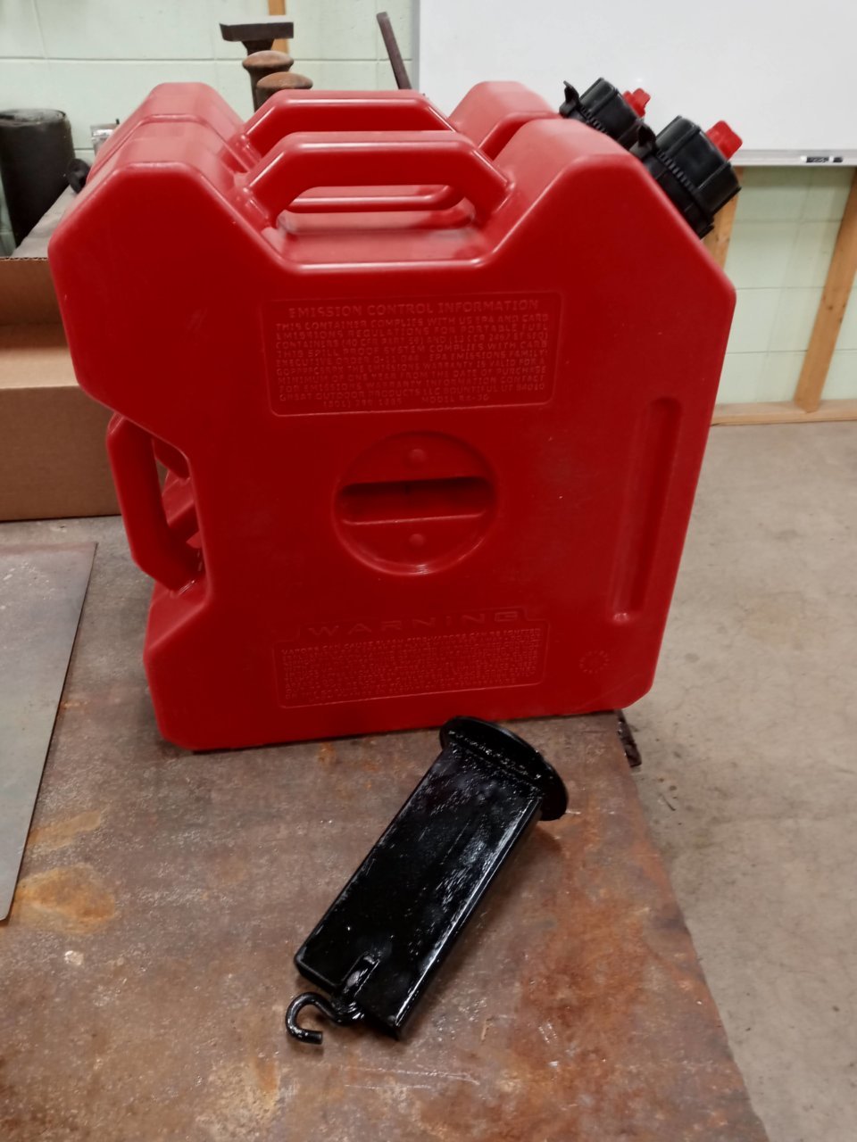

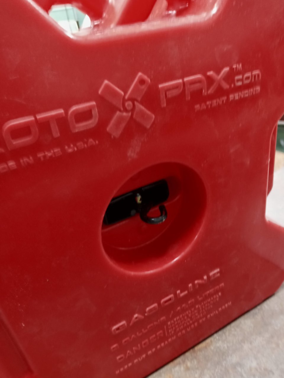

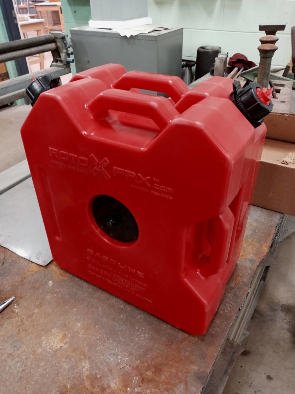

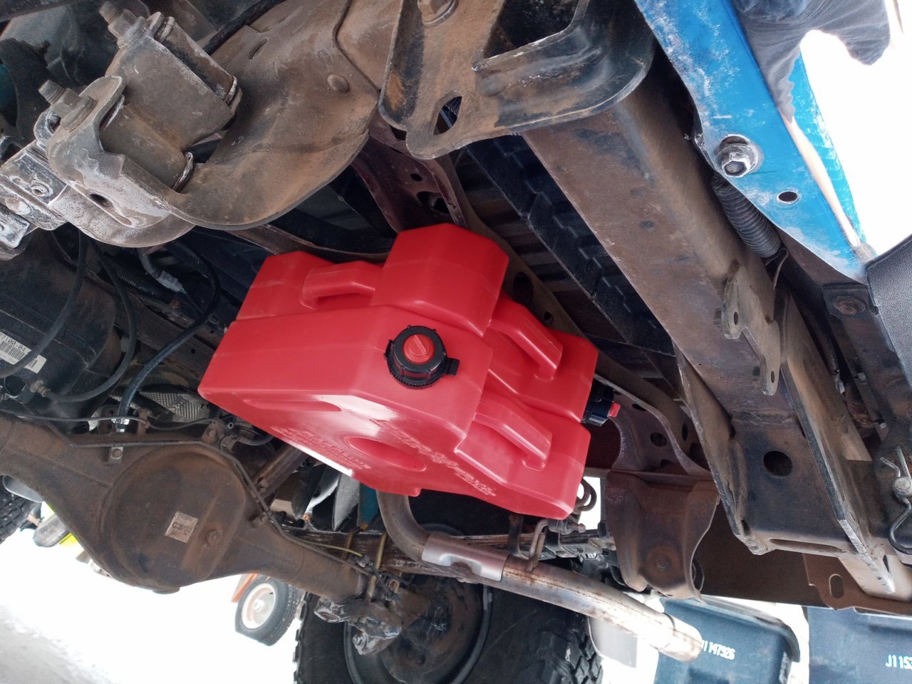

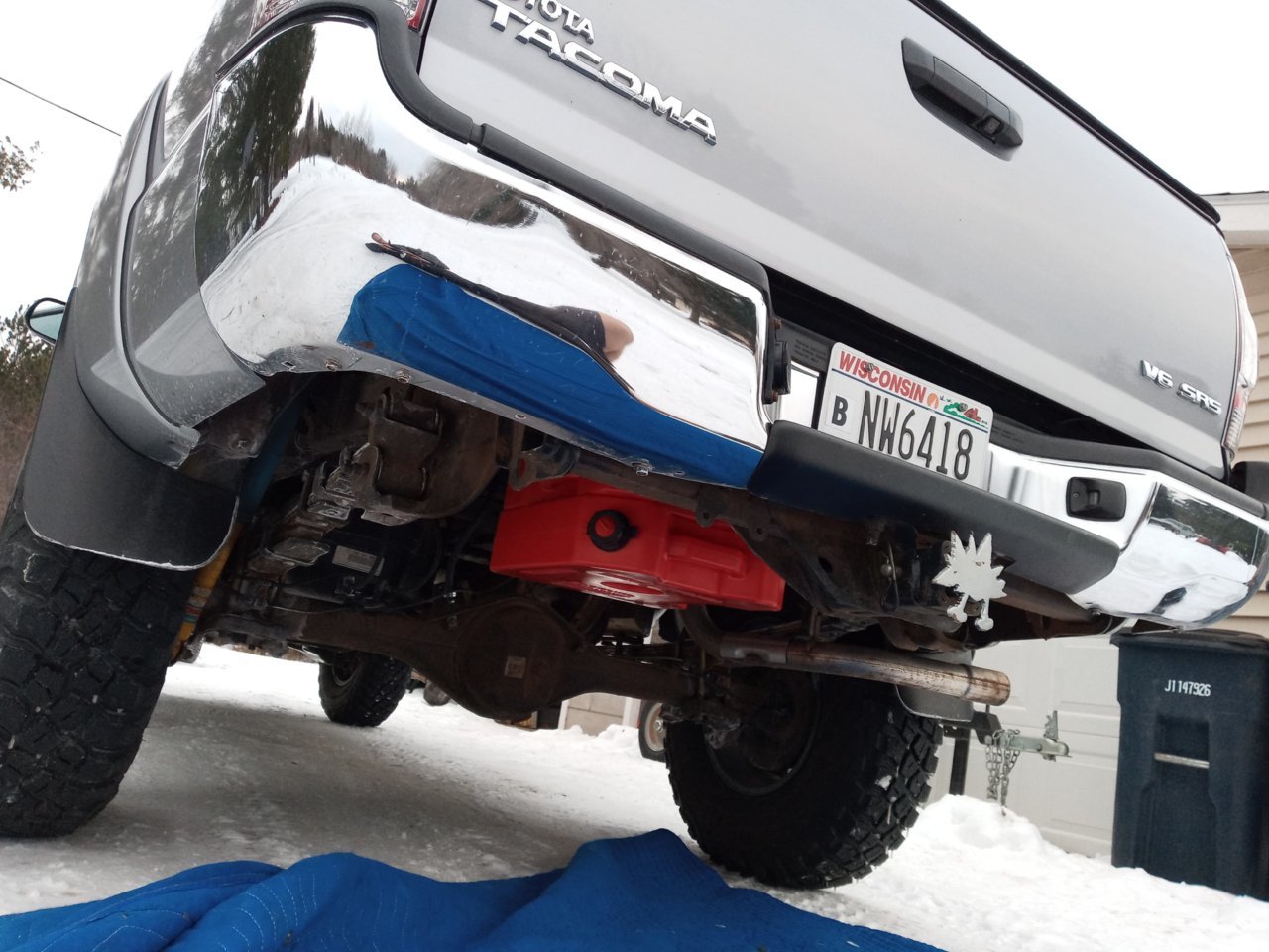

    posted this on the 2nd gen page but thought this might have more interest here. Been wanting to find a way to carry additional fuel where my spare was. Looked at Trail'D but they are not approved for fuel and my goodness they must be gold plated. Bought some Roto Pax as blems and made a neat mount. Check it out:
    Mounting is easy, solid and the factory wheel end on the chain is intact. Awesome!

    This is a pretty creative idea! Helps keep center of gravity low, mostly protected. I'm not sure if this would be all that big of an issue with the given location, but for peace of mind I would build a skid plate of sorts to help protect them. A slight pia to get to and check on, but possibly not any more then otherwise would be depending on your set up. Is your spare in the bed of the truck now?

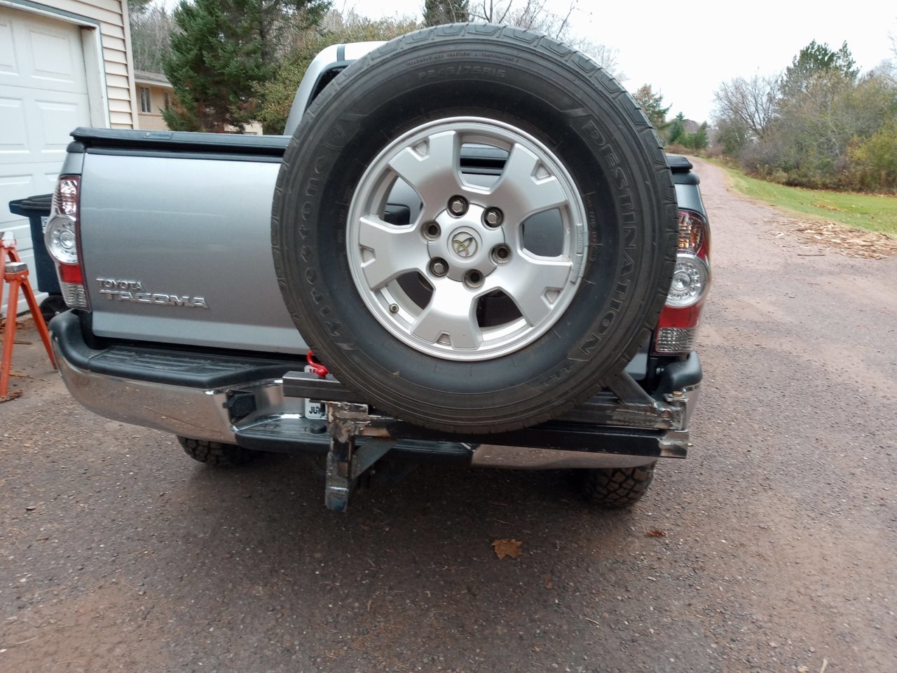

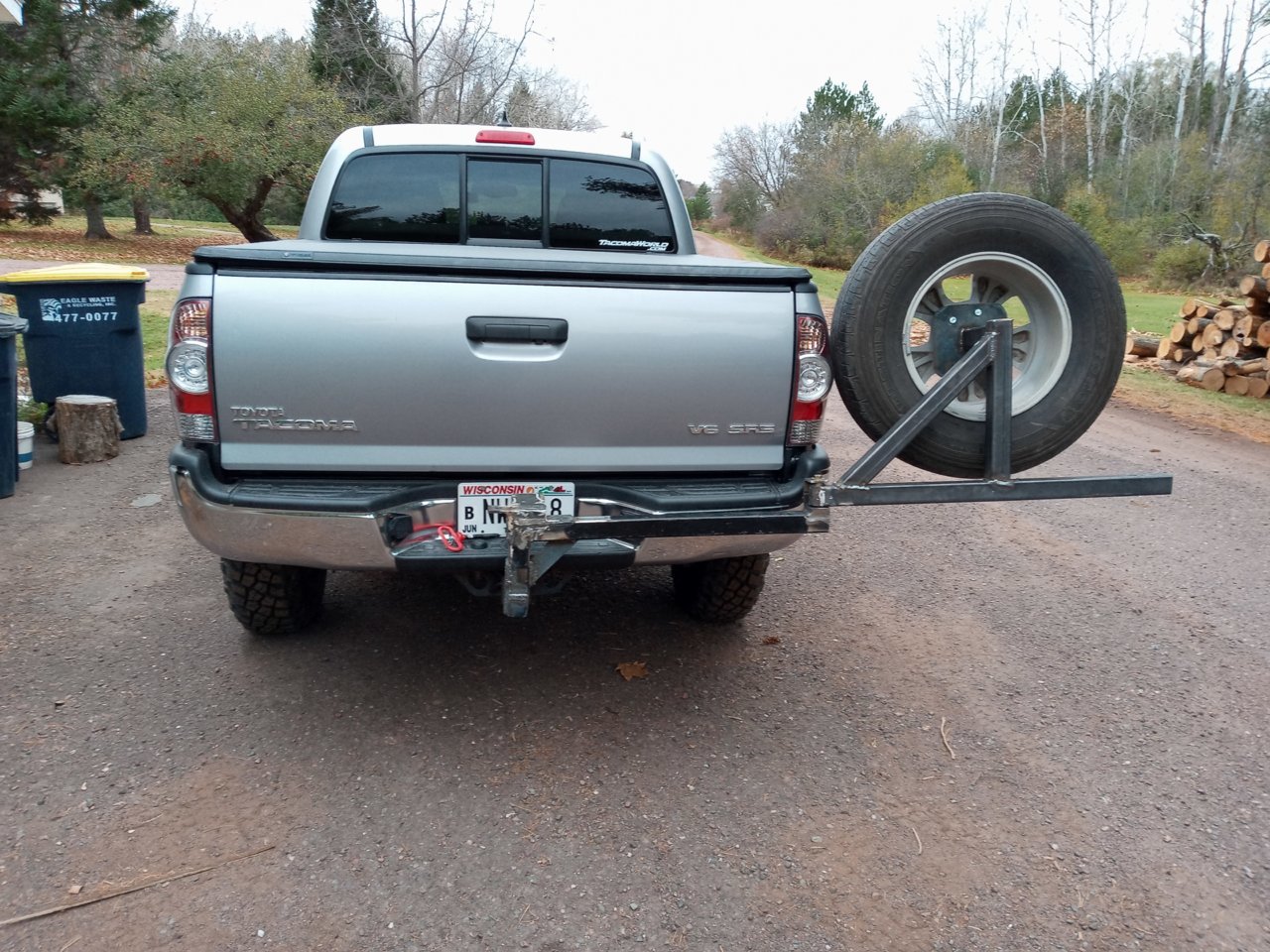

    I built a swing away that uses the receiver hitch.

    Your fuel tank has a skid plate for a reason...
    Where’s your spare tire now?

    The pictures don't show how much room there is around the tanks. To get to them and crush them would probably be an un-survivable wreck anyway. A concern I am willing to live with as the tanks will only be there when I am out there wheel'in. Also, the factory fuel tank is right behind the front wheels and will get hit with everything coming off the front wheels. These are way up and protected well by the rear axel and such. Can it happen? Sure, but again when I am using these I am not going to be driving 60 mph on dirt roads... Can they get crushed or hung up on? Yup, but in my experience over the years I have never hit the spare tire (on my other off road rigs-and this includes being in places the truck shouldn't have been such as the Rubicon and Fordyce trail etc.) I'm not 20 any more, and have invested way too mush into this rig, so lower level wheeling is the rule. Accidents do happen, but I know they are there and will drive accordingly.

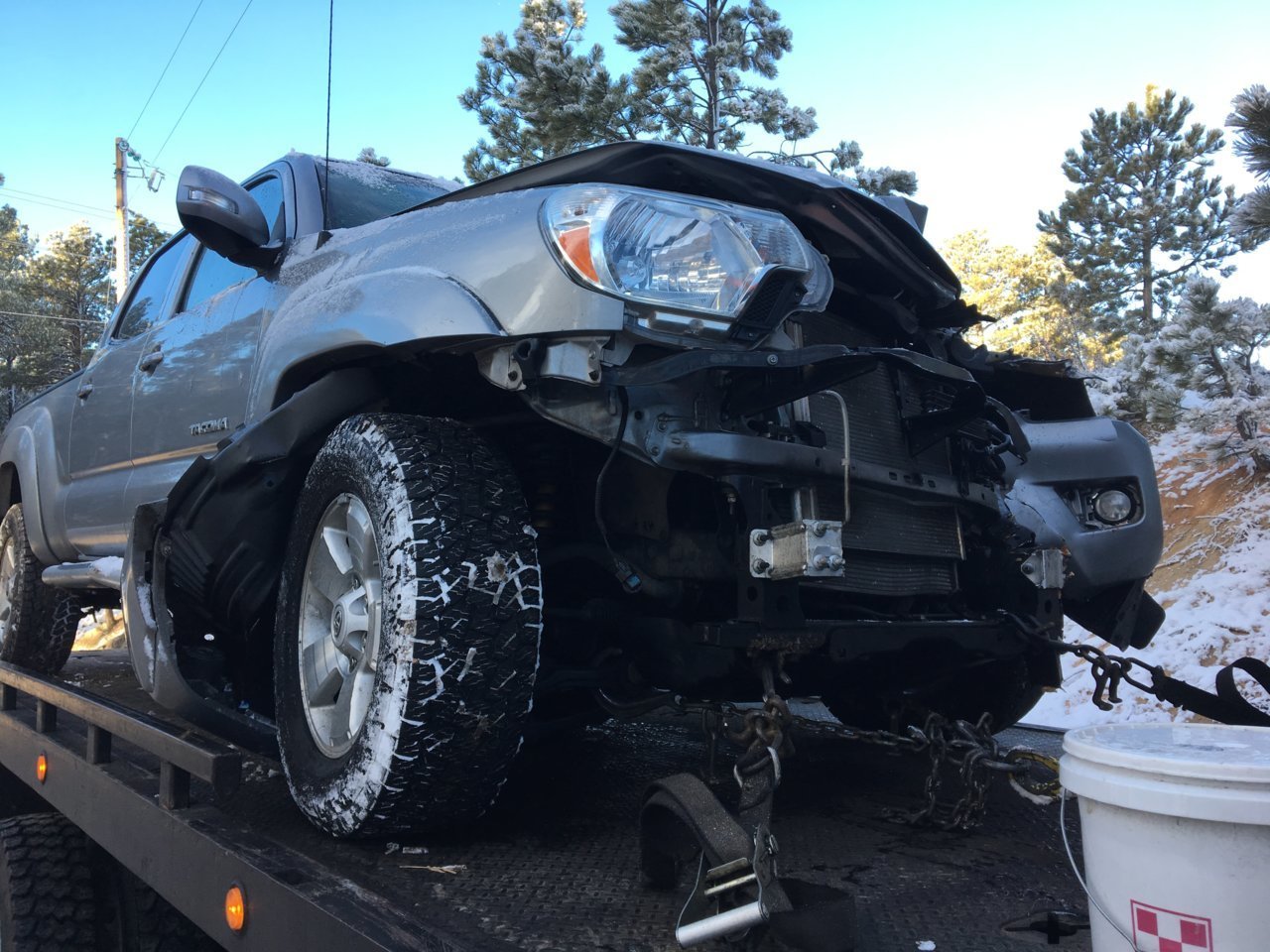

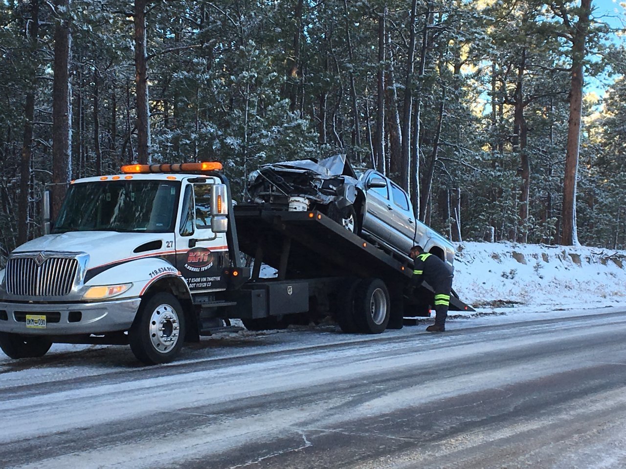

    20 mph....
    1FB2D3EF-787D-4432-8CBC-BC95858BAF7A.jpg 137CC2A4-72C0-43B5-AC41-8D1748F673E1.jpg

    Yup. Nevermind wheeling when your rear comes off a rock or a ledge....

    The only other thing, other than safety from anything hitting the rotopax underneath or getting hit from behind, is the massive heat coming off of your exhaust. Heat + Melting plastic with flammable liquid inside = not good

    I've never hit my spare tire on a rock either. But it is *often* the case that rocks, logs and whatnot flip up and hit the underside of my truck while wheeling, even on tame fire roads. As I said before, the stock tank has a skid plate for a reason. And that reason is not because these trucks are designed for the 'Con.
    You're obviously skilled at fabricating. Why not take that extra step of protecting them with a skid plate, or make a mount for them on the swing away?
    You take extra fuel so you don't get stranded. Would suck to get stranded because of one little rock or a log.

    I hear you... I have seem amazing damage to bikes that made no sense in context of place and time. This location is a compromise and won't be used often. I have had tanks in the bed in the past, but sleeping arrangements and my sanity dictate a different arrangement. I already used additional space on the swing away for a propane tank (another way to go boom!) I will look at what a 3/16 guard might look like...
