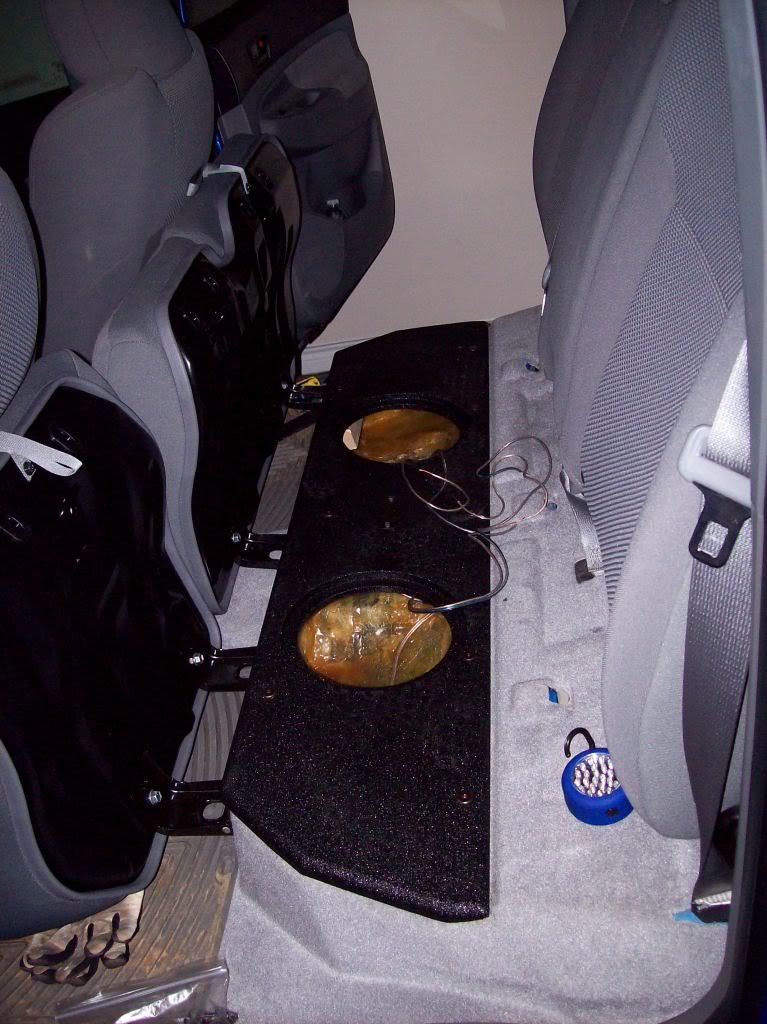

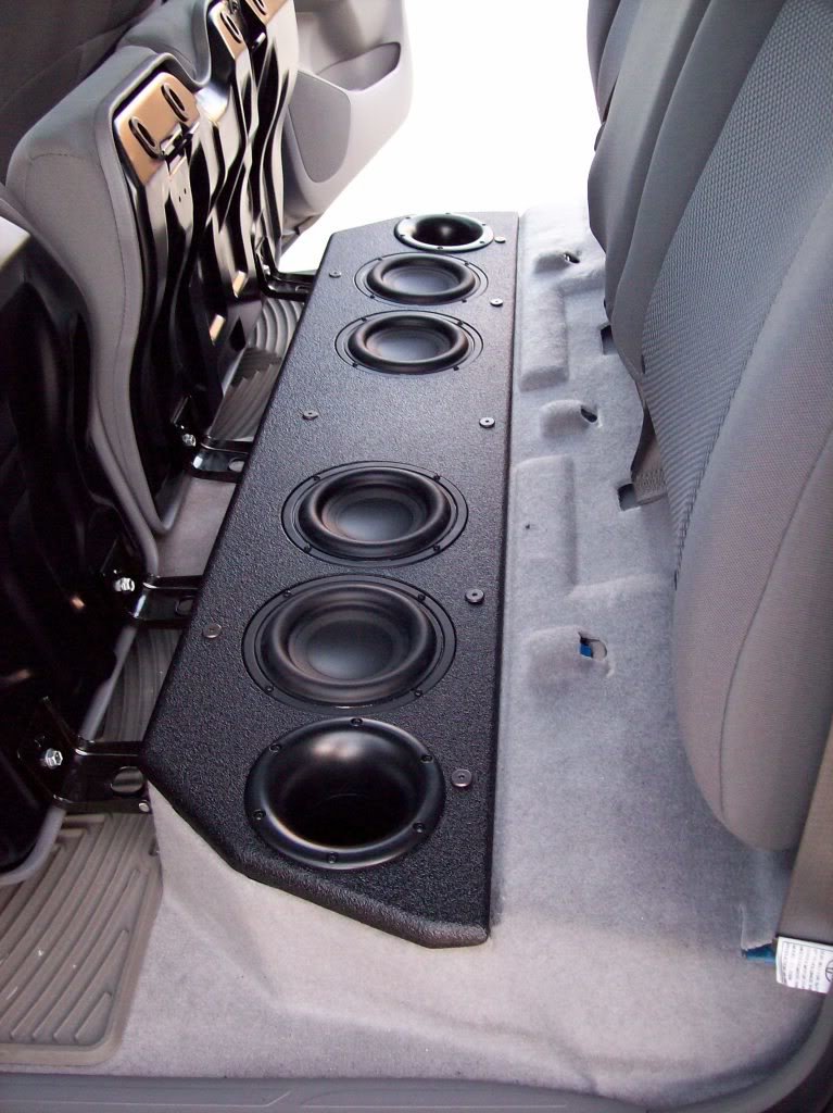

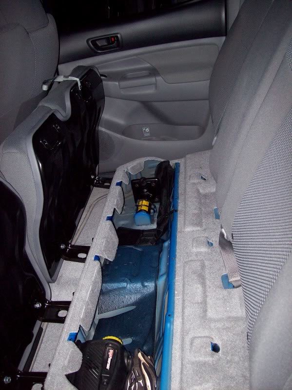

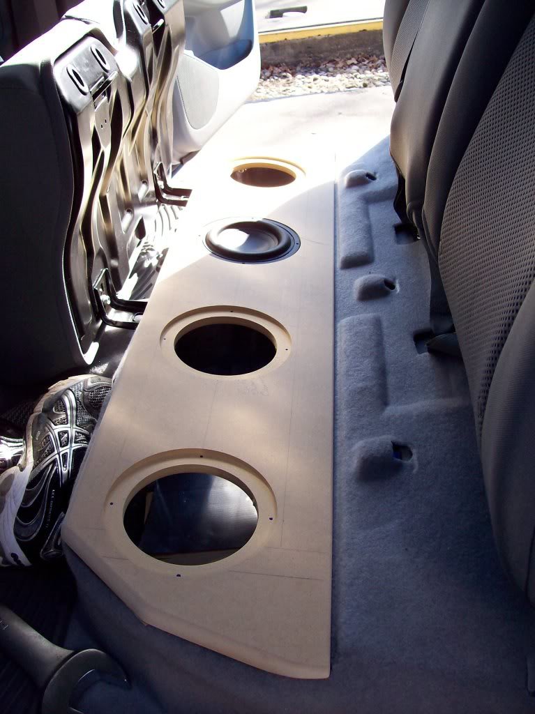

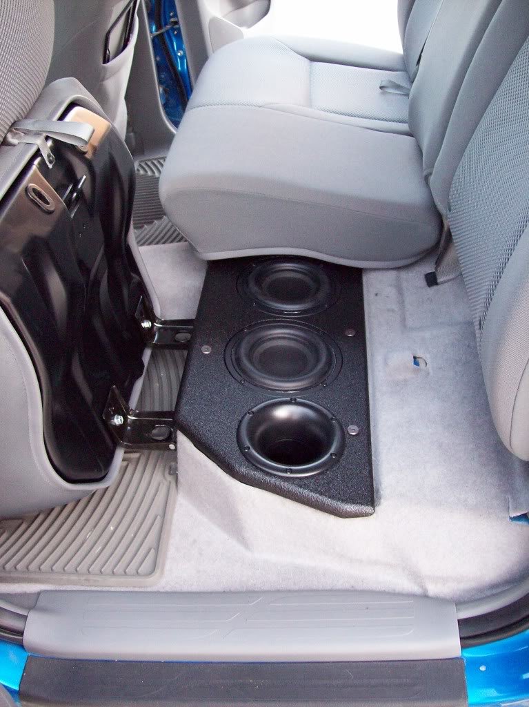

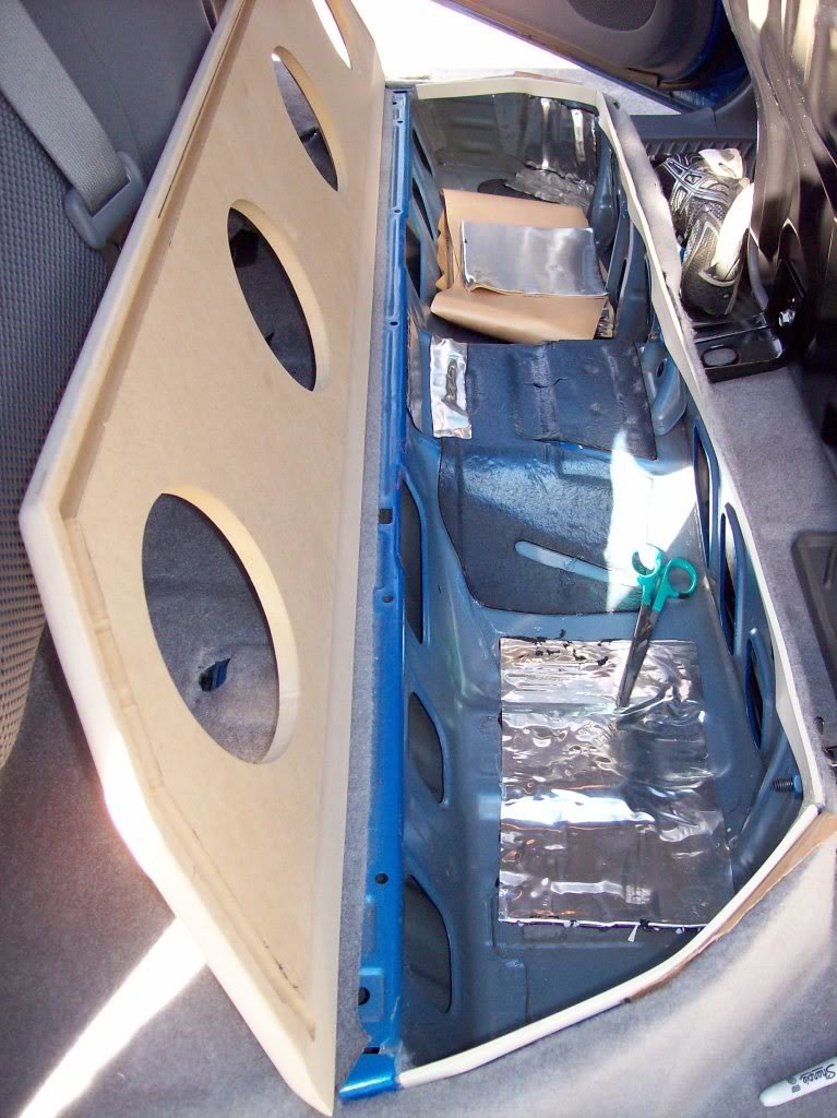

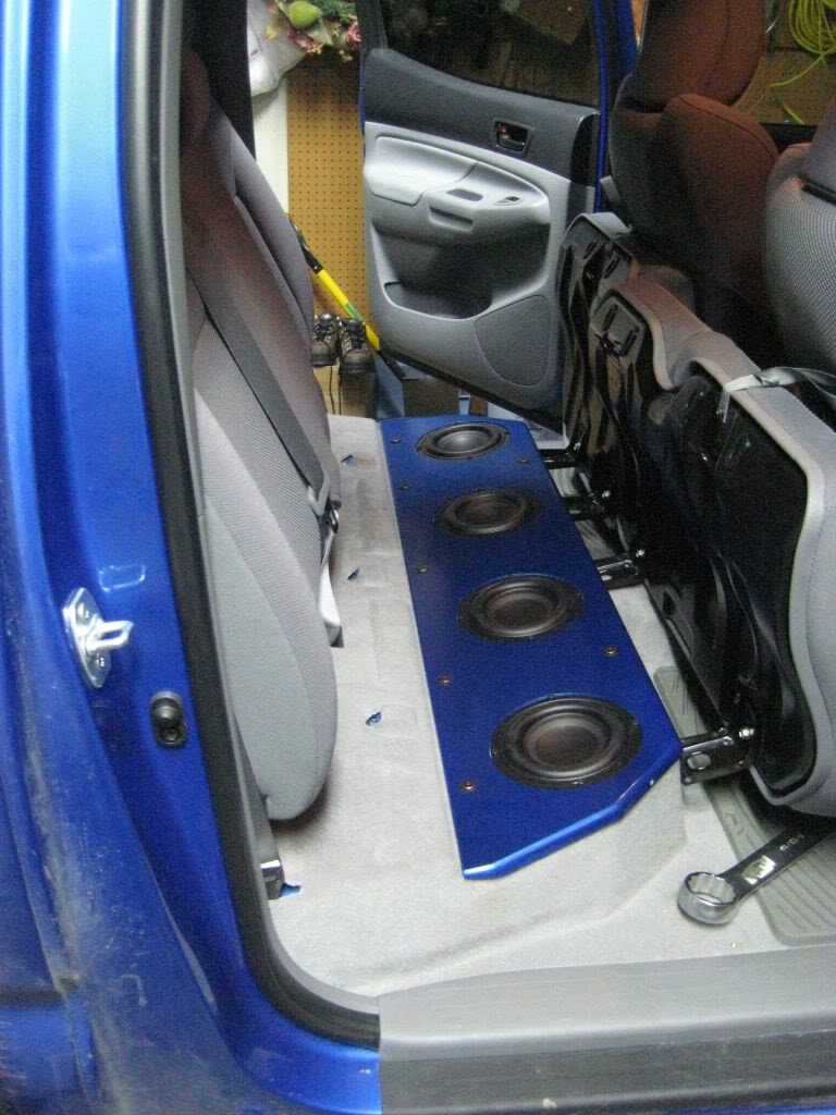

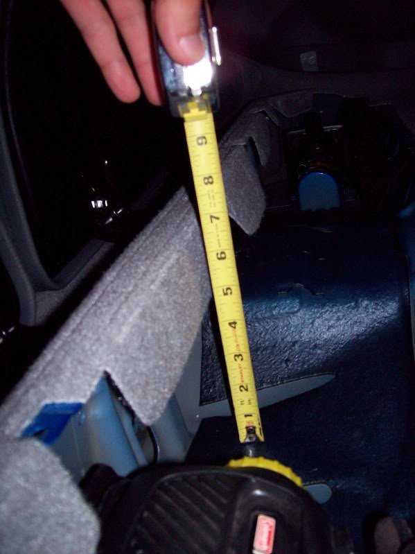

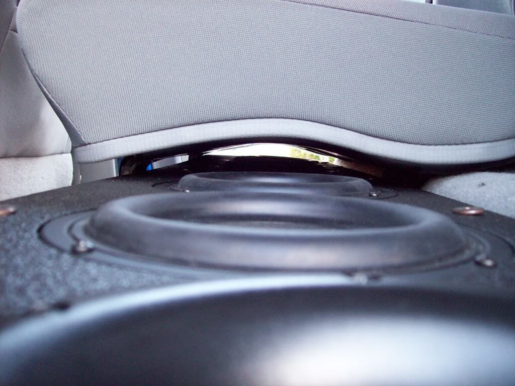

    Yes, it's possible....no, it's not easy. First you need to seal the area below there. My suggestion (and what I did) is fiberglass it. You wont be able to get it out, learn to accept this. Go into this project assuming that success is the only option. Make sure you glass in some wooden beams (I used 2x2's) that you can tap with a threaded insert to be used as attachment points toward the front.
    All pictures are in order from initial conception to where it stands now. Currently I'm running the two sealed E3.8 subs from Elemental Designs. It's perfection.
    You said you wouldn't mind hacking away down there so I'm offering this advice assuming you have somewhat decent fab skills.

    Well, sealing the area below seemed like it would be necessary anyway. That's fine. Fiber glassing, you mean the bottom no? if so, why would that be a problem? Is it just that I wont ever be able to put the storages back in? Because that is definitely not a problem. As far as fabrication skills. Ill do it carefully. I'm sure i'm up to it.

    I'm not sure what "fuckfitting" is but I'd recommend using lots of lube.
    10's will not fit because the flange is bigger than the baffle area is wide. You would have to perform a miracle to have them fit. Not saying it's impossible but I never figured out how.
    You also need to cut the bin metal so it's all on one plane. What I mean by this is that in it's stock form it's mostly flat and then slopes off at another angle. You need it to ALL be a perfectly single plane at an angle so you can use one board. It's the key to getting this right and making sure you get a good seal.

    Ok so I went and read your whole thread about the project you did. Wow... Lots of pics and great info. Good god man, your work is awesome. That thread should net you +1 bazillion gazillion rep...
    Ok so as far as components, I think ill be ok. Cutting should not be a problem. I read what you did and while it has to be precise, it wasn't much what needed to be cut. Ill just measure a million times before cutting.
    Now, I see what you meant by glassing the bottom. When I went and read, it was an issue of needing to seal it perfectly. Now that I understand that, I have no problem with doing so. Ill just glass the hell out of it. I don't plan on letting go of this truck anyhow.
    Only problem im seeing so far, would be the board itself. While im sure I could make the board, it's probably not going to come out perfect, because honestly that is not my craft, so I don't have the required tools for that to come out perfect. Ill have to see what I can do about that. I have a friend who is an artisan and he does really good wood work. However it would be more about borrowing his tools... :rolleyes:

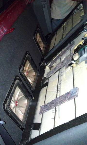

    I set my system up like this. It's loud and sounds awesome! I think I need to get a capasiter...
