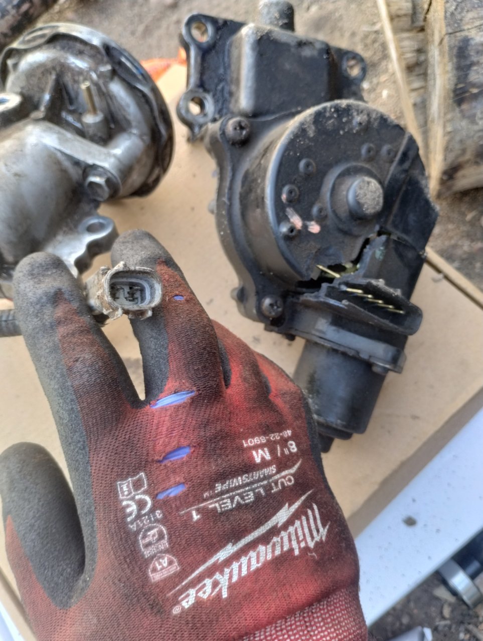

    Good morning all. I'm in the process of replacing the clutch on my 2001 tacoma. And I came across my differential actuator being broken. Now I have a spare one however it is off of a 4Runner. Now I know that both actuators fit in the same differential so I don't see why I couldn't use the one off the 4Runner. Now my issue is the wiring the wiring off the 4Runner differential actuator only has two wires. And the differential actuator off the Tacoma has six wires now can anybody help me with a wiring diagram or explain to me how I can wire this up to make it work. I've attached the pictures for reference.

    They're DIFFERENT. 4R are vacuum control and your 01 is electronic. Will not work.

    Because I haven't seen a conversion done and will be nice if someone can make it happen. Especially for the 01-04 model with the electric actuator.
    IIRC, on the electric one, it's 5 prong pigtail. 2 are for ground and 3 for power. I could be wrong because it's been years since I looked at one. On the 4r, the actuator is controlled by a vsv that is activated by a switch on the tcase and the 2 wire pigtail is to indicate engagement/position.
    So is it possible to make it work, definitely. Is it worth the headache to source the parts needed to make it work, probably not. That's why I haven't seen a conversion done/write up. So yes, it will be interesting to see a write up on one. But it will be easier to source the correct actuator or to solve the potential rust issue in the future, swap to the manual locking hub and j case.

    1,793
