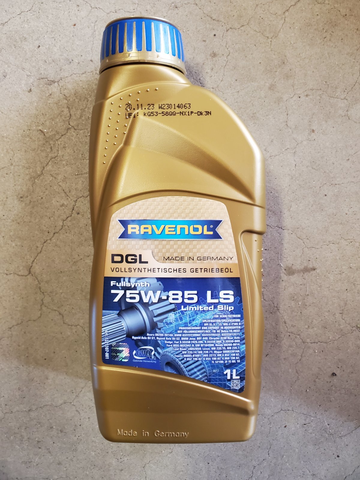

    I just did Ravenol 75w-85 in front and rear diff and Ravenol 75w in the transfer case. I'll come back in 100k and let you know how they did :bananadance:
    Purchased from Blauparts.

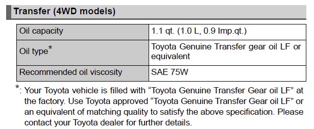

    The Owner's Manual just says 75W for the transfer case. The differential section in the specifications page of the owner's manual states GL-5. The manual transmission section specifically states GL-4. The transfer case section makes no such distinction. Not saying folks on here are wrong, based on their experience, but the book says 75W. That's likely why the Car Care Nut says use the same stuff in the diffs and transfer case. I do know that GL-5 has a much higher percentage of certain stuff that eats soft metals in synchros in manual transmissions and that's why GL-4 is specified. Perhaps that "extra" stuff is seen as necessary in the transfer case. Don't know - not a seasoned mechanic. I'm just going to follow the book on this one.
    Claudiomartinof and DrivinWheel like this.

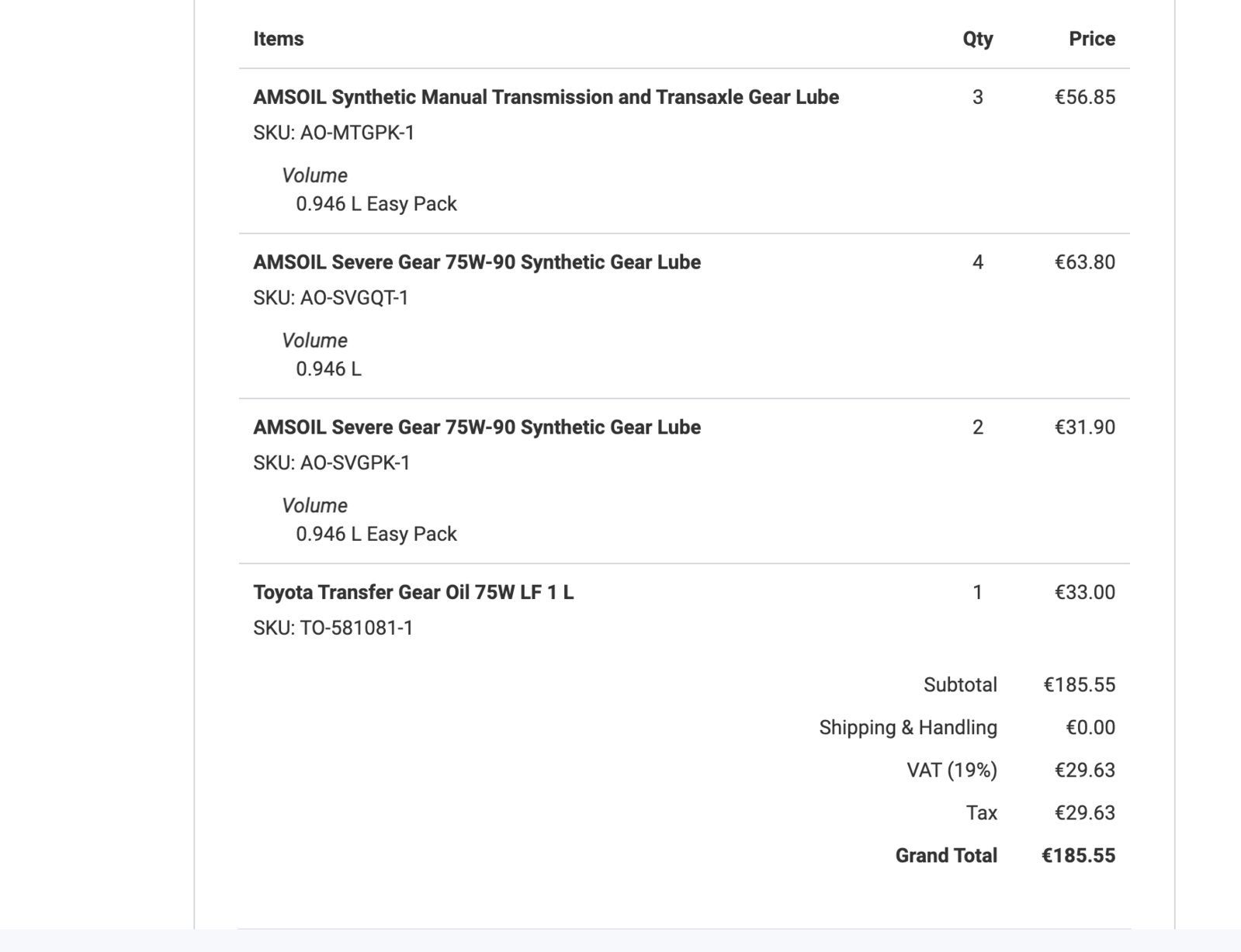

  20. May 20, 2024 at 7:23 AM
    #20
    TheDanimal
    TheDanimal Well-Known Member
    Nov 8, 2021
    #381613
    170
    Daniel
    DFW
    2024 Silver TRD OR 6MT 2019 MBM TRD OR 6MT (RIP)
    This is what I did for my change. I went with Amsoil Severe Gear in the Diffs, Amsoil Manual Transmission fluid, and I ordered the Toyota OEM transfer case fluid. It was much cheaper in Europe (about 37 USD at the exchange rate back then) so now that I am in the States I guess I may have to cough up a little more money. The site only had two EZ pours of Severe Gear in stock so I ordered 4 of the regular ones. In hindsight, since its more expensive, I should have just bought one EZ pour and then refilled it with the regular ones after I put the original content.
