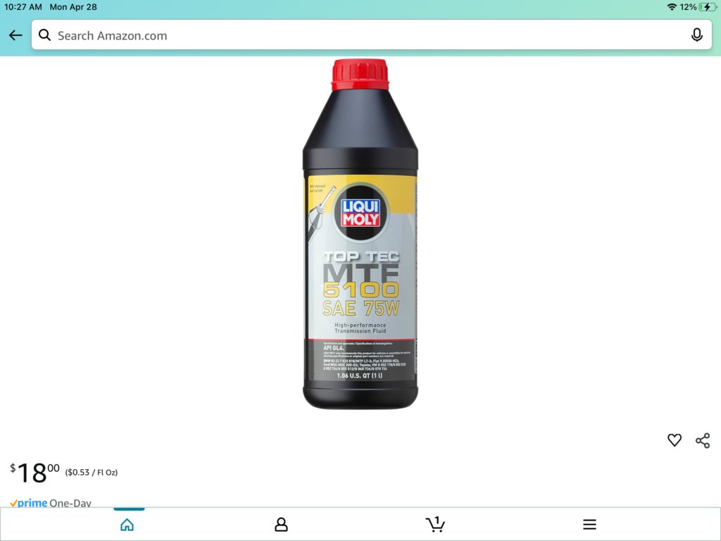

    Thoughts on this for the transfer case?

    Wow we got folks here using Redline. I've been using Redline since 1995. Great stuff, my current old 2003 beater pick up truck (not my Tacoma) has over 330,000 miles on it all with Redline fluids in engine, trans, both front/rear diffs, and transfer case. The motor is all original never been apart or out, same as the Trans. never been apart or out of the truck. The rear diff I did swap out for new locker. Other than that it's been great stuff.
