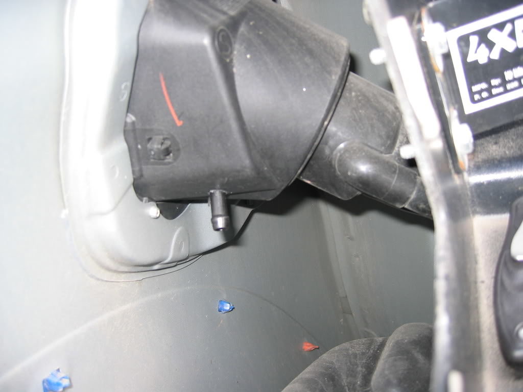

    i did this yesterday and my truck has 30k miles on it and my OEM breather was rusted and had all kinds of stuff falling out of it once i took it off. i guess deep snow is just as bad as deep water. either way its done now!

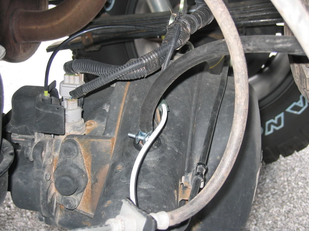

    Seems like a good idea to relocate it, looks like me next mopd is trip to Autozone. Good write up and great pics. Congrats to the OP..

    I just did this mod this past weekend, took me about an hour, but I was doing other things at the same time. Overall cost about $20 and was very easy. Hardest part was getting the new breather seated in the 1/4" tubing, what I tight fit.

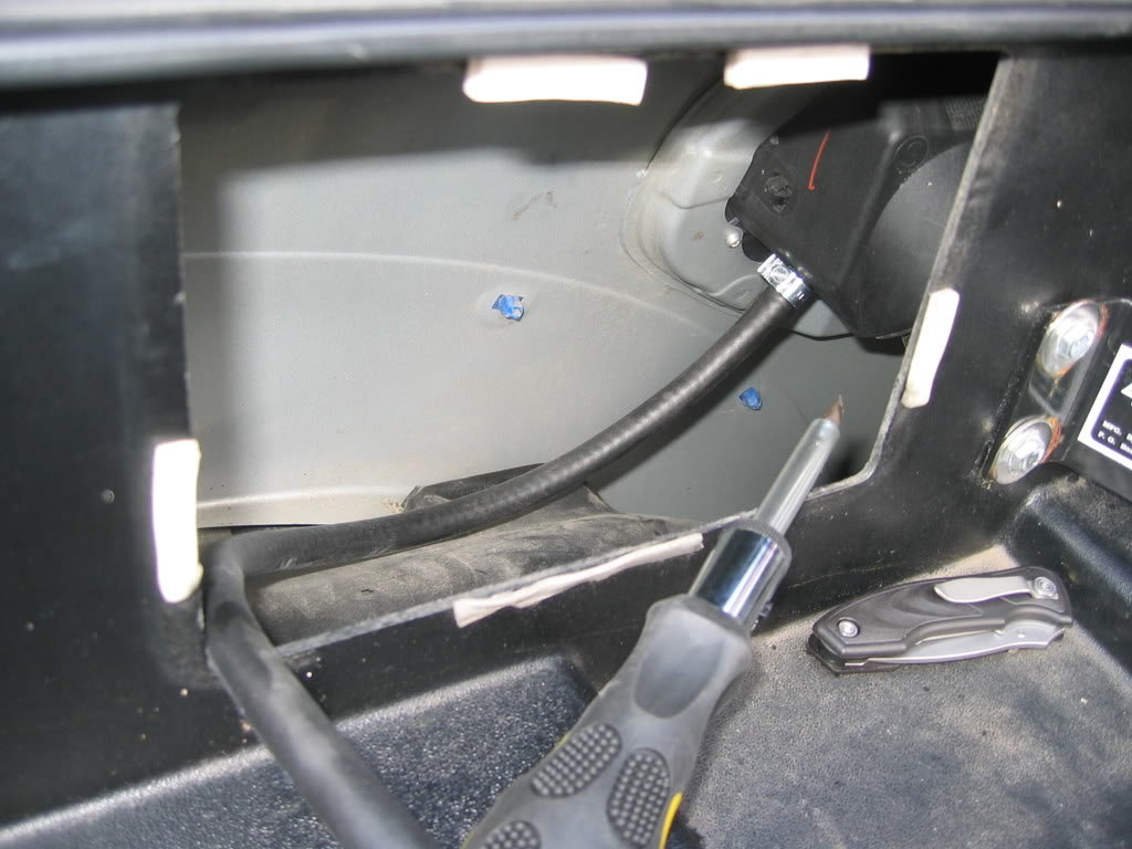

    I'm having trouble popping my cubby back into place. Any suggestions?

    I had more trouble getting it to come out than I did getting it to go back in.
    You have to 'rotate' it in to place. Mine didn't make any obvious clicking noises or anything but it's in there securely and doesn't move.

    Maybe I broke something when I pulled it out. The tabs look ok but its not locking in. Thanks for you reply.

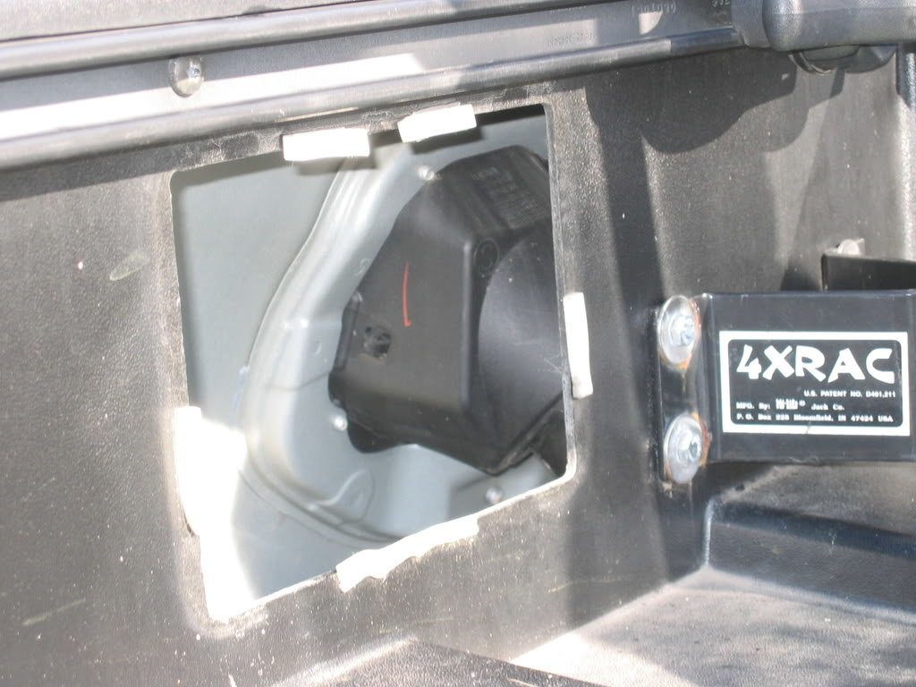

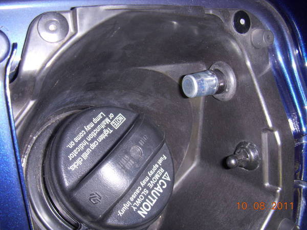

    Did this today, took no time at all. Relocated into the rear bed cubby (the one with a cover).

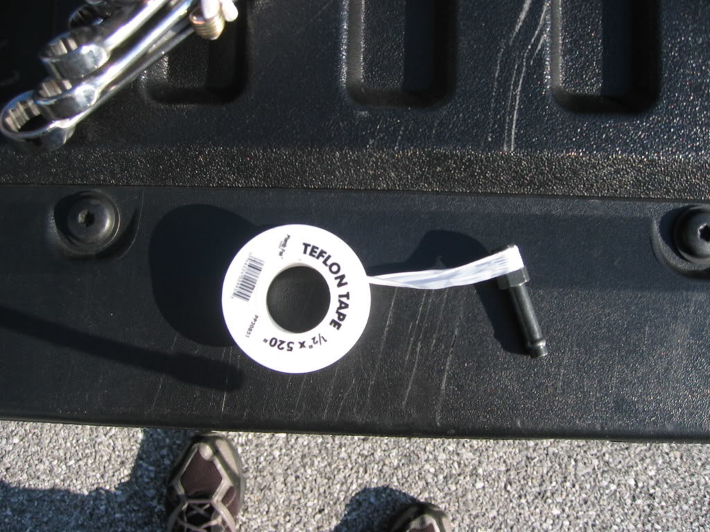

    Just because everyone asks, parts are still out there and available from Toyota.

    Why do some of the mods for this on different forums substituent Part 90404-51319 for Part 90404-51026? Are they interchangeable; I need to know if I have ordered the wrong part for my 2012 Taco.

    These are the parts I used and they work just fine. You are getting a 2 way breather as replacement as well since the OEM part is a one way breather and would still suck water through the seals.
