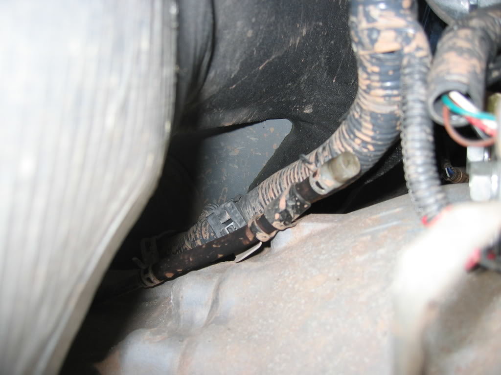

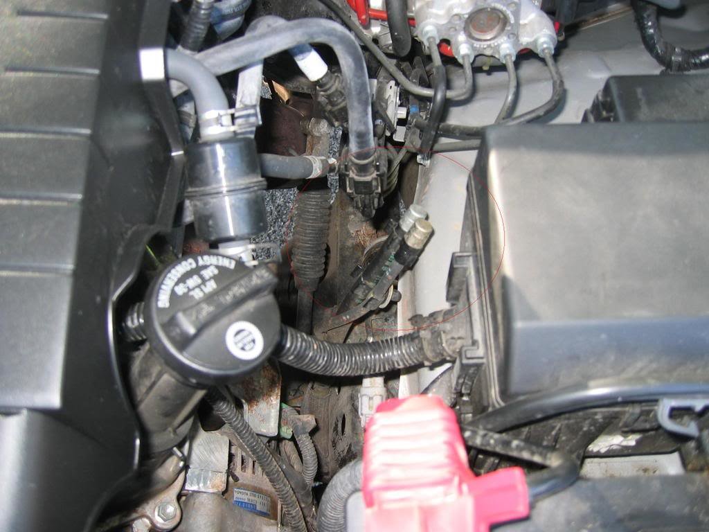

    I believe the front ones were relocated at the factory. Somewhere around the battery there are 2 tubes with breathers in them. Which only begs the question of why Toyota would extend the front, but not the rear? :confused:

    Yes I think you are right: Here is a picture of a trans breather that has been extended to just behind the block.
    Here is another picture of two front breather I found on the driver's side fender.
