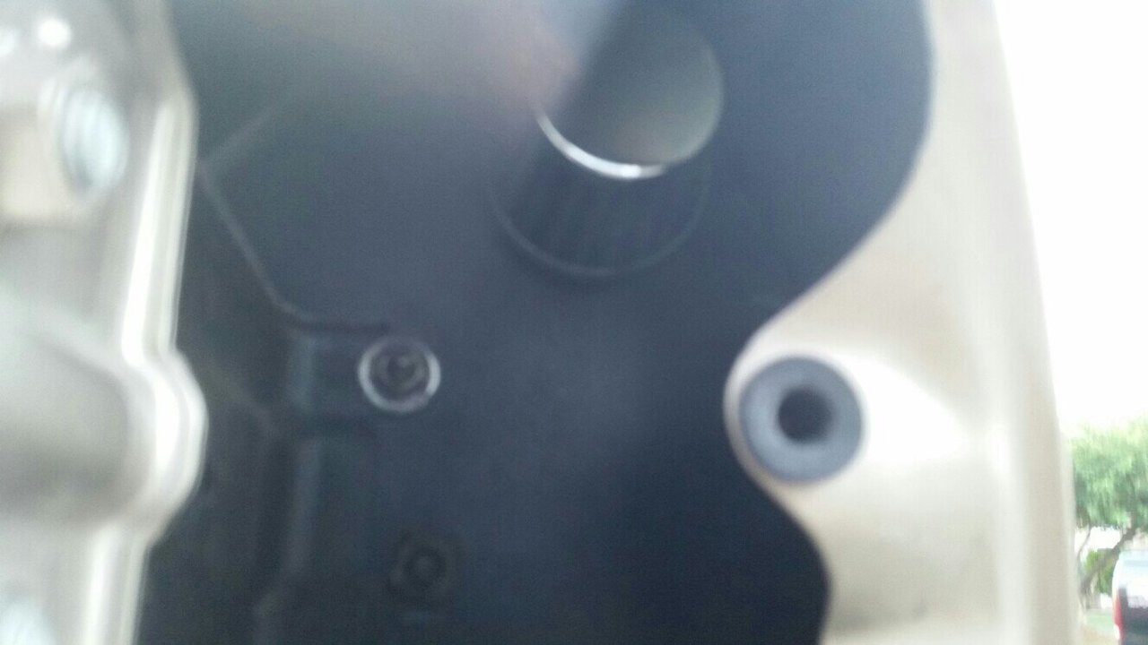

    Check this spot out for the BREATHER relocation. The Bulkhead of the tail lights. You can go as high as you want, all the way up to the bed rail. Drill a hole in there, and mount the filter.
    In that spot, it is higher than the engine bay location, bed box, and gas spout location.

    How many ft of hose did that take? I just bought 6ft. I may try that. I don't want it in my bed or bed pockets and i really wasn't crazy about it being in my gas filler area where it could get contaminated :/

    I mounted mine up there on the drivers side. Took about 7ft, but I left plenty of room for axle movement.
    92d45b79ec592ee2728b15a1972b1e7b_zps0e06_bd1ca3cb8cb4f3b7d5cfbc40bcda30f68ccc3db9.jpg

    Nice. Like that others are utilizing that area. Drivers side or passengers side is equidistant from the breather area. If you are worried, buy 10'. use what you want then return the rest. I mean, it is sold by the foot, right?
